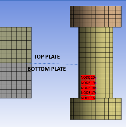

I am assessing the results of a RHS connection subject to shear. Within this i am looking at how the stress-strain changes along the shaft of the bolt, an i cannot resolve a discrepancy with the curve for node 16, shown below, which is at the bottom of the bolt shaft and in contact with the bolt head.
(mesh in image below has been refined)
September 18, 2021 at 2:42 pmpeteroznewman
SubscriberTry inserting this command into your model:
ERESX,NO
