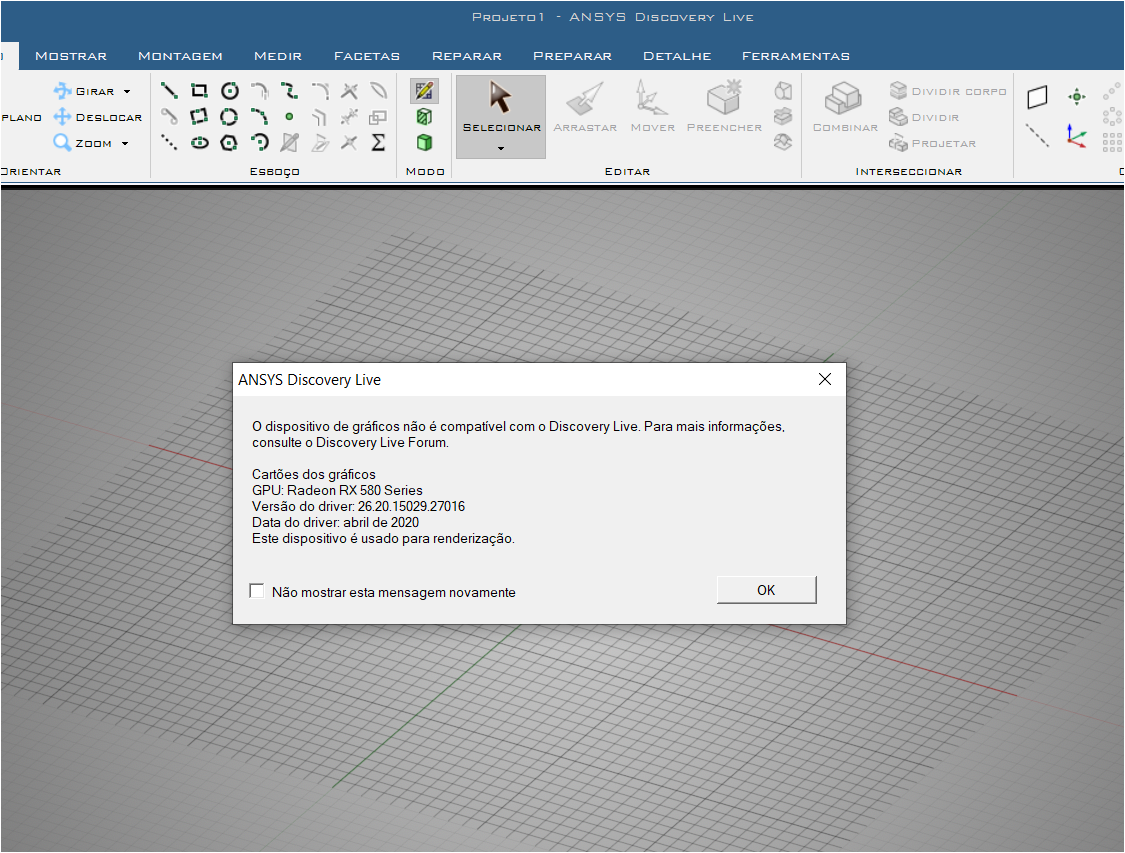

Discovery Live graphics card question
    • henriquepo13
      Can you help me?
      Note: My vídeo card is update
    • Naresh Patre
      Hello Henrique Engineer
      Discovery Live requires an NVIDIA graphics card.  AMD GPUs are not supported.
      Please refer to the Hardware Requirements for further information.
      • henriquepo13
        Naresh Patre You can explain me in a technical way why this happens?
    • Naresh Patre
      Discovery Live technology was built and tested with Nvidia cards only. You can find some more information about Nvidia Vs AMD cards at this link.
