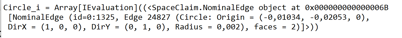

      I have multiple hole edges in a Named selection group. How can I get edge center locations to variables in a script?
      With this command:
      Circle_i = Selection.Create(NamedSelection.GetGroup("BoltHeads").Members[0]).Evaluations
      I get this result:
      But how can I extract Circle Origin locations and direction from my Circle_i ?
