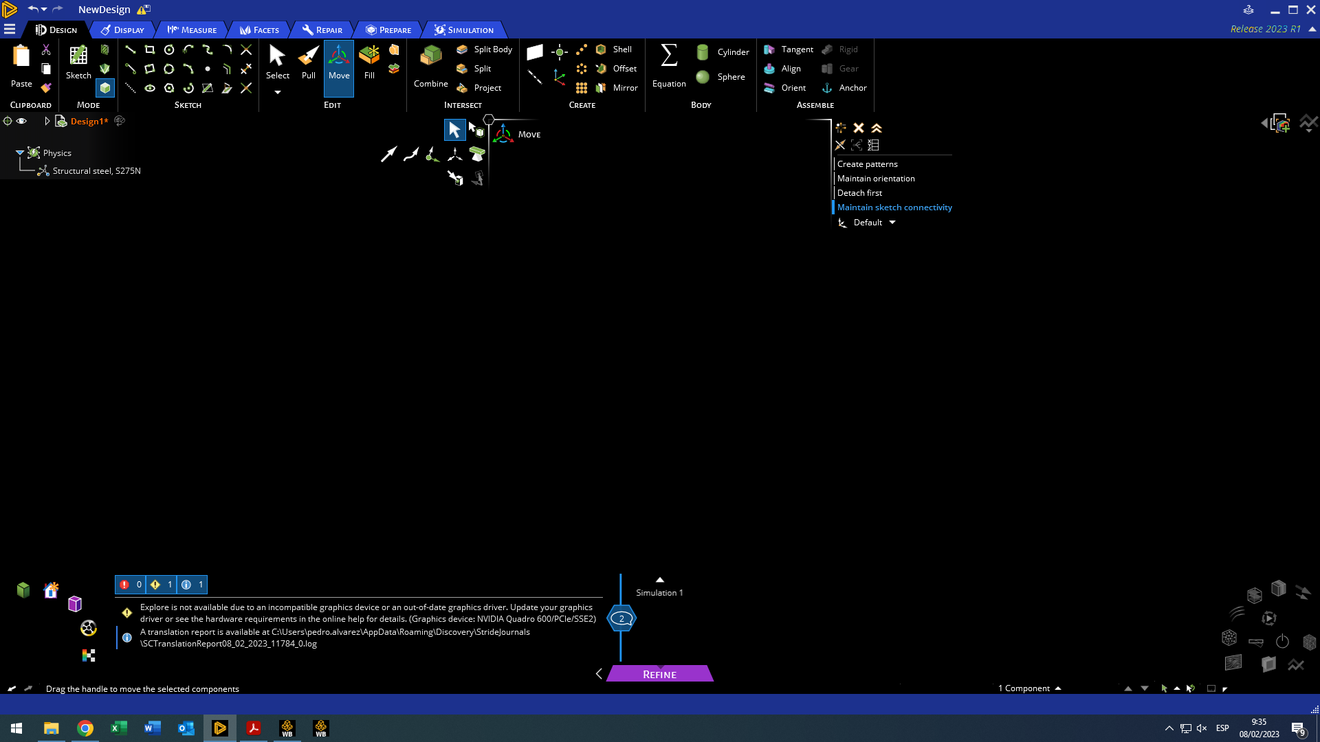

SubscriberWhen I start up ansys discovery and try to import a STEP design,the program does not show the design and the following error appears on the bottom of the screen:
-Explore is not available due to an incompatible graphics device or an out of date graphics driver. Update....
-A translation report is available at ... -

Ansys EmployeeHello @Pedro
The Discovery Explore mode requires the following graphics card requirements:- Discrete NVIDIA GPU, Maxwell series or newer (Pascal series or newer preferred)
- 4 GB dedicated GPU RAM (minimum)
- 8 GB dedicated GPU RAM (recommended)
Please check out below article on Hardware requirements posted on Ansys Discovery forum:
Ansys Discovery Hardware Requirements (2023 R1) - Knowledge Base - Ansys Discovery Forum- Naresh Patre

SubscriberWhat type of hardware can be used

Ansys EmployeeHello @elaine shen
Please check out the below link for Hardware Requirements:
Ansys Discovery Hardware Requirements (2023 R2) - Ansys Knowledge
