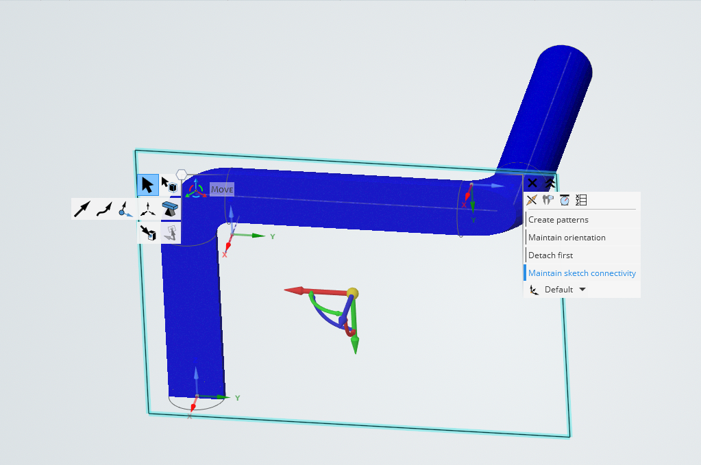

SubscriberI am viewing a pressure contour result in Discovery 2020 R2. I am wanting to view the pressure on a plane. I can click on the Cut button and that sort of works, but it shows the wrong side of the flow volume than what I want to see. How can I toggle the cut view so that it shows the other half of the flow volume, or alternatively just show the results in the plane of the cut?

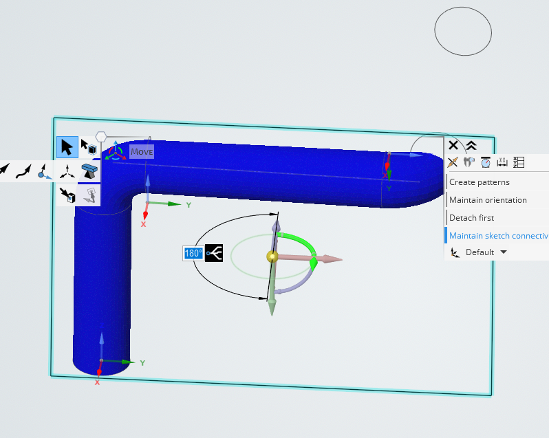

SubscriberHello Ted Harris , To toggle the cut view (or to change the plane orientation in general), click on the cut plane and this will show the triad, with which you can move the cut plane (by 180° to toggle the view), or adjust it according to your viewing needs. ÂI hope this solves your issue. Regards.
