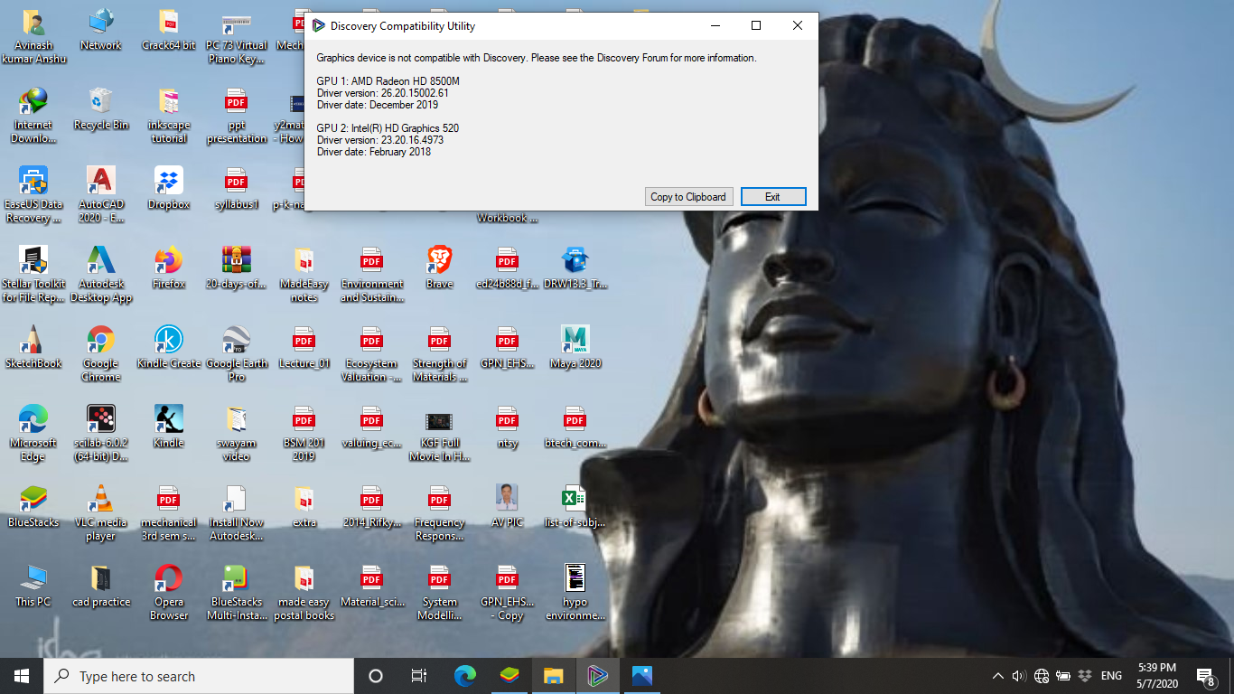

      i am unable to open discovery live 2020 R1 in Ansys Discovery Live Student 2020 R1.

      Discovery Live does not function on an AMD Graphics card. For more information on hardware requirements for Discovery Live please refer this link.

        hello Subashni licence is not the issue here, the issue is that i am unable to use Discovery Live. is there any alternative to use discovery live
    • Subashni Ravichandran
      Hello AVINASH
      Unfortunately, there is no alternative here. Discovery Live requires the right hardware (NVIDIA Graphics card with Keplar, Maxwell, Turing or Pascal architecture and a min 4Gb RAM) to function.
