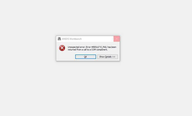

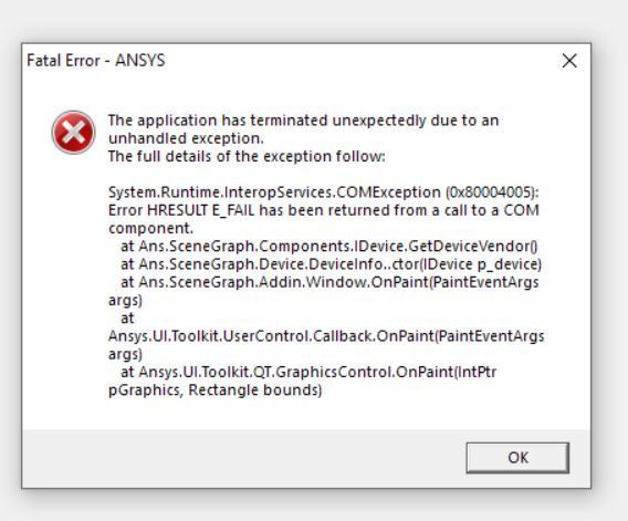

      Hi Support
      Do you know what may cause the error in the images above?
      Fatal Error - ANSYS
      The application has terminated unexpectedly due to an unhandled exception.
      The full details of the exception follow:
      System.Runtime.InteropServices.COMException (0x50004005):
      Error HRESULT e_FAIL has been returned from a call to COM component.

        It seems like HRESULT E_FAIL is not necessarily specific to AIM.  Do you know if the user installed using Run as Administrator, or has full administrator privileges on the PC?
        It looks like AIM is checking out the license and then checking it back in almost immediately, usually within about 30 seconds.
        I'm waiting on some feedback about this.

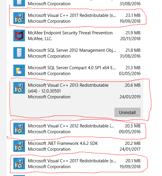

             3. Finally - we have seen issues with some machines getting corrupted but have not managed to determine why in these cases repairing the install of the Redistributable runtimes from Microsoft has resolved the issues:
