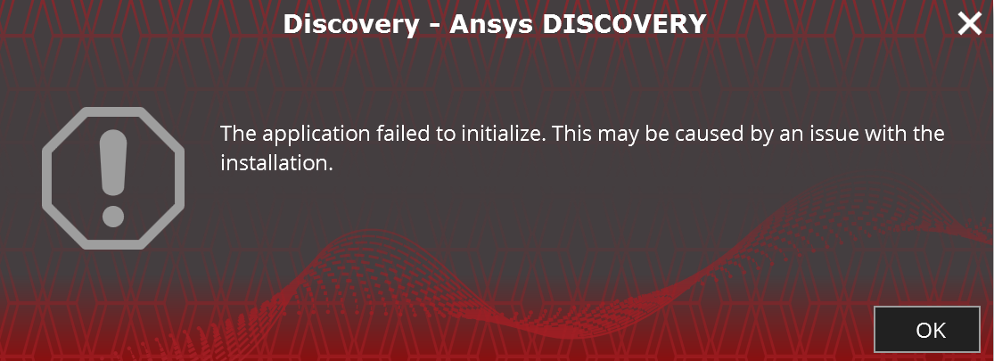

Please try disabling Intel graphics on the machine.
Also please try installing the latest redistributable. You can try installing the appropriate one from here:Â Latest supported Visual C++ Redistributable downloads | Microsoft Docs
Please try installing the VC_redist.x64.exe and vc_redist.x86.exe for Visual Studio 2015, 2017, 2019 and 2022 package. If you already have 2015 installed, you may need to uninstall before installing this downloaded version.
Currently Discovery is not officially supported on Windows 11. Will confirm with the upcoming releases.Â
