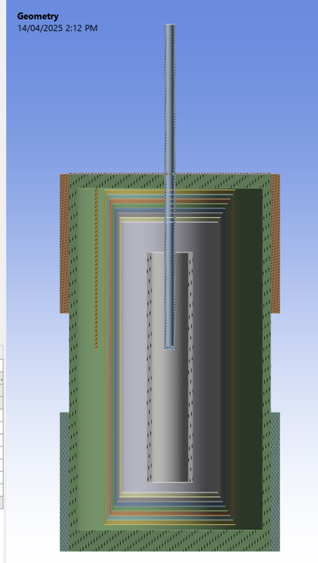

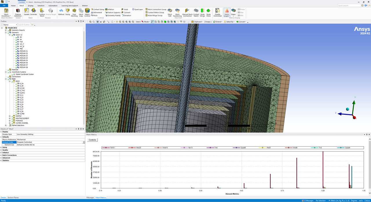

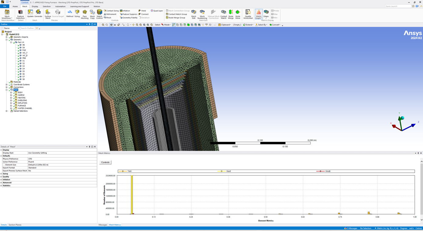

      Hi all, For context, I have a furnace model with 8 layers of very thin shielding (0.05mm) that encapsulate the heating element. I created those shielding using Create>Thin/Surface in DesignModeler. Then, I meshed everything, and the result was bad quality meshes only on the shieldings part. (tag #1) Then, I asked on this form of how to increase quality mesh of a thin body (https://innovationspace.ansys.com/forum/forums/topic/increasing-the-quality-of-a-thin-surface/), I was suggested to use "Midsurface". (tag#2) It is very good actually. But, when I transfer it (#2) to Fluent system, I got this error message: I got two question:
      1. How to solve the error "surface meshes cannot be read under...."?
      2. If I decided to not fix the mesh quality, stick to the #1 option; transfer the bad meshed model to the fluent system, and once in Fluent, I can activate the Shell Conduction model to simulate thermal behavior across these thin layers, is my option acceptable?

        To clarify, I’m simulating a vacuum furnace that contains heating elements, shielding layers, and a sample tube, surrounded by a water-cooling system. My goal is to analyse temperature distribution inside the furnace. I choose Fluent because I currently learn it at Uni.

      Have a look at shell conduction in Fluent. For heat transfer we can model the solids as a solid, but there are alternatives.
