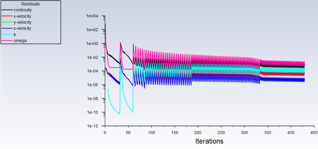

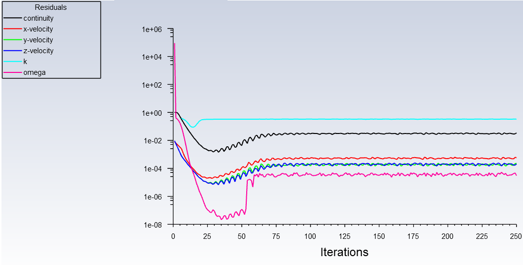

      I'm currently trying to simulate a small flow through a pipe with varying diameters. I attempted to reduce the residuals in my steady-state simulation, but it didn't work as expected. Therefore, I switched to a transient simulation.
      However, I'm encountering an issue with the total pressure values. In the transient simulation, the maximum total pressure at the inlet is 0.172 Pa, while in the steady-state simulation, it is only 0.069 Pa.
      Here are the residuals:
      Steady:
      Transient:
      Could you please advise on why these differences might be occurring and how to address them?
