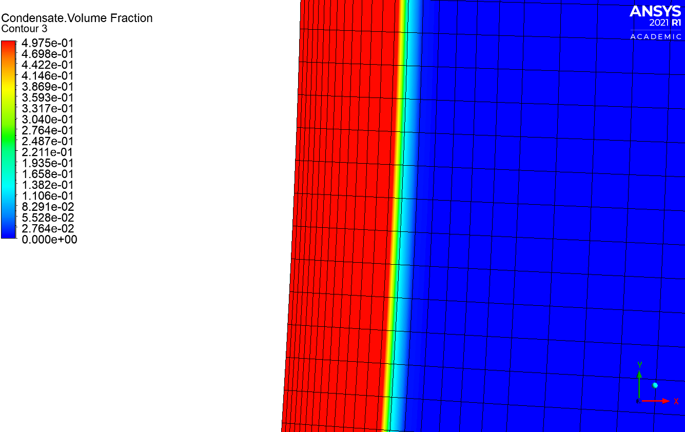

SubscriberI'm simulating condensation of water on a 2D pipe. I have written a UDF using the DEFINE_MASS_TRANSFER macro to determine the mass transfer rate of the vapour via using an energy balance method which forces the interface temperature to stay at saturation temperature each time step using this law.

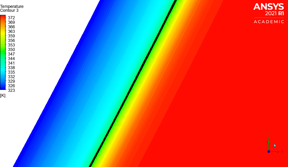

When using the compressive interface tracking method with a slope limiter value of 1, I've manage to validate the film thickness against the Nusselt theory. However my heat transfer coefficient/heat flux values are completly wrong. I obtain a value of around 2500 W/m2K when it should be 9000 W/m2K. I've even set the reference temperature to be equal to saturation. The same can be said for the temperature and velocity profiles. Also, the temperature at the interface does not equal saturation as it is meant to. This can be seen on the picture
Although, when using the geometric reconstruct, the film thickness is much larger than it should be but however, I obtain higher heat transfer coeffcients than I did with the compressive method (4500 W/m2K). And the interface temperature is closer to saturation (369K).
I'm not sure why the interface temperature for the compressive method is much lower than saturation but I obtain the correct film thickness, not to mention having much lower heat transfer coefficients as the heat transfer coefficient is a function of the film thickness due to thermal resistance?

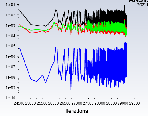

SubscriberConvergence and mesh is fine. I also looked at the ansys users guide and said that compressive is typically the best for evaporation/condensation problems due to it being able to capture the diffusive interface as well as the sharp interface. And the slope limiter is essentially the degree of compression at the interface.

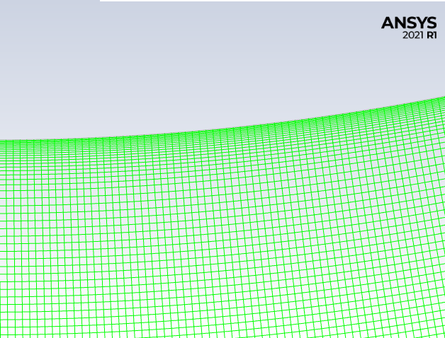

Forum ModeratorHow many cells over the gas/liquid layer?Â

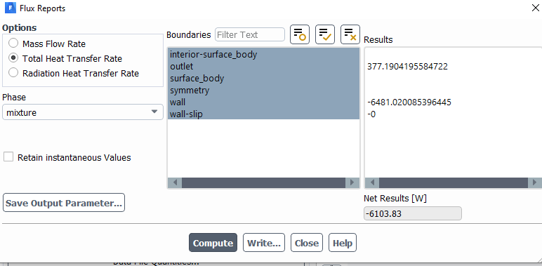

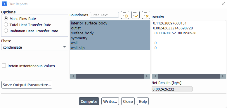

Forum ModeratorNot sure. You mention the heat flux is out as well? Does the heat in/out correctly match the latent heat?Â
May 12, 2023 at 2:20 pm
May 12, 2023 at 2:21 pm
Navsing
Subscriberlatent heat of vapourisation for water is 2257 kj/kgÂ
May 12, 2023 at 2:36 pm
Rob
Forum ModeratorCheck gas mass in and gas & liquid mass out. You're trying to see if what goes in comes out again.Â
