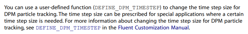

      Hi-There is a Define_dpm_timestep UDF. Is this to control the particle injection frequency or control the trajectory integration time step? I now realise that it may be the former. I have attached the screenshot from userguide. Can someone please clarify this.
      Time step for injection and tracking updates.
    • scabo
      So it is not the particle trajectory integration step size?
      Doesn't look that way.
    • scabo
      Okay but in the Fluent UDF User Manual 2025 R2 page 267 this UDF is used to limit the particle time step size to one fifth of particle relaxation time. I think this indicates that this is the time step used in particle trajectory rather than injection settings? Shall I forward the picture of the page?
      The time set in the DPM panel is used by the injection AND to track a parcel update. So if it's set as 1s new parcels are added every second and each parcel is tracked for the shortest of one second or until the max steps are reached.
    • scabo
      Yes but the udf define_dpm_timestep is for particle integration step. This is because fluent udf manual uses it like that as mentioned in my last message. Am i correct?
