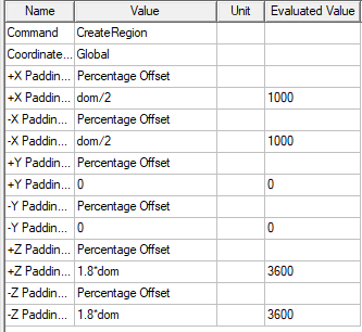

      I am studying self and mutual inductance and I wish to understand what are the main differences between Maxwell and Q3D when calculating those values. As I understand so far, both use the system's energy to determine the inductance. However, in Maxwell, the result changes a lot depending on how large the bounding domain is. In Q3D the calculation is done without a setting up such a domain.
      The test is done on two parallel rectangular conductors, with 1A current flowing in the same direction. I tweaked the domain size in Maxwell so that it matches the Q3D result.
      The domain in maxwell is drawn with the region command, having the following values:
      1. What tweaks should I make in Maxwell so that I can ensure correct inductance calculations for similar rectangular structures?
      2. Why does the size of the bounding box have such a big impact on those inductance results?

      Hi, this creates what's known as an open boundary problem. In such cases, the magnetic field does not stay confined near the conductor — it extends far into space. With FEM, we must artificially truncate the domain, and as the region grows, it includes more of the weak but non-zero field at the edges. Since inductance is calculated from the magnetic energy (L = 2W/I²), any increase in total energy due to these additional field contributions will increase the apparent inductance.
