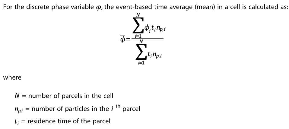

Rob
Forum ModeratorWhat is it being reported on? If it's referring to a number of parcels in a cell it's likely a cell value as a particle value is held on the parcel track.Â
June 3, 2026 at 9:10 am
aniruddhabose96
SubscriberYes the result is a cell value but the phi within summation is summed over number of parcels or particles and then the cell value is returned. Is this a correct interpretation?
June 3, 2026 at 10:24 am
Rob
Forum ModeratorDoes it give you the value you want to post process?Â
June 3, 2026 at 10:25 am
aniruddhabose96
SubscriberÂ
If the quantity inside the summation is particle variable, then yes. Also I am assuming when you time avg the particle velocity then all the fluctuations becomes zero and we only get the mean vel of particles.
June 3, 2026 at 3:35 pm
Rob
Forum ModeratorHow are you averaging the particle velocity in the Lagrangian framework?Â
June 3, 2026 at 3:40 pm
aniruddhabose96
SubscriberIf you see the above definition, the summation runs from 1 to N parcels or particles. So that automatically averages the particle properties in the lagrangian framework and then wighed by the number of parcels and residence time to give a cell value. Is that correct?
