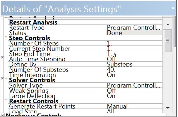

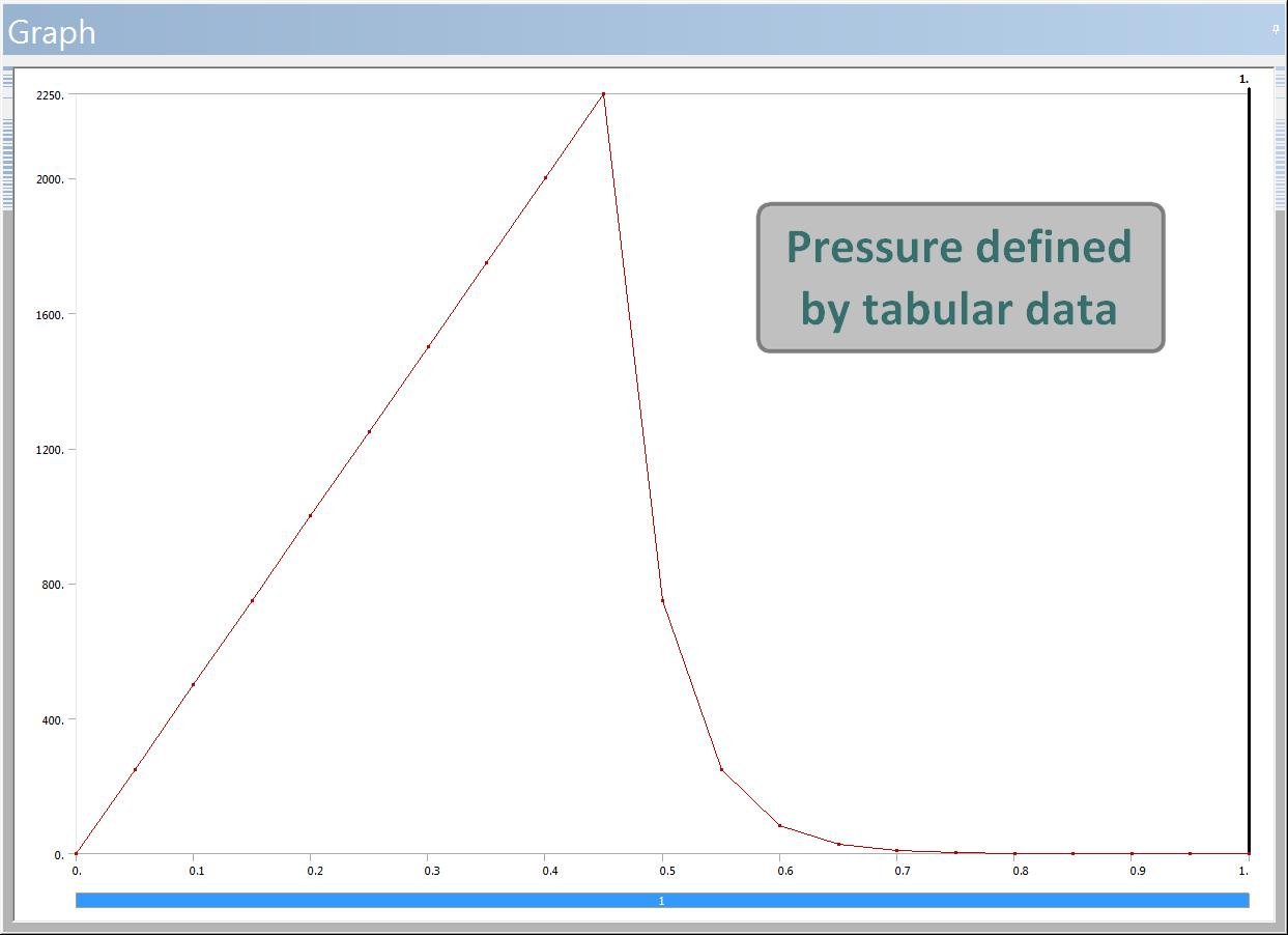

      Along the way I started to wonder if there was some difference between ramping pressures with Substeps vs. Timesteps, as far as the system response.  So I made two copies of the same system, the first one uses 40 substeps over 1 second, as seen in these Analysis Settings:
      The solution using substeps is shown in the following gif.  As can be seen, the cylinder compresses and when the pressure drops it oscillates as expected.

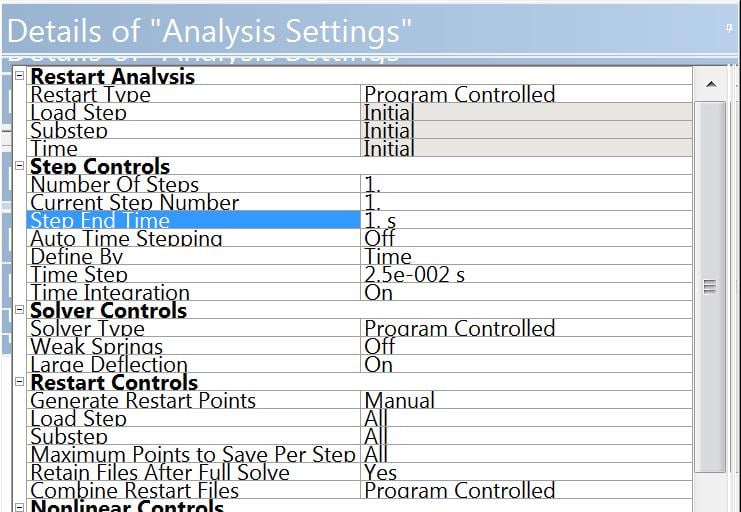

      The second model uses a time step size of 0.025s from 0 to 1 second for a total of 40 time steps, with Define By set to Time, as shown below:
      This is the only difference between the two systems.  The time stepping model seems to give a similar solution until the pressure drop, at which point it fails with a "Highly Distorted Element" error.  The animation for this model is shown below:

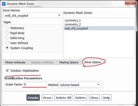

      As you have found, FSI cases with hyperelastic materials can exhibit numerical instabilities. This is also true for cases with thin membranes and incompressible fluids. I recommended modifying your fluid to be compressible. For liquids the density will be a function of the pressure and bulk modulus.
      The recommended method to reduce numerical instabilities is with Solution Stabilization in Fluent. The workflow for this is described in the solution "Solution Stabilization for FSI and 6DOF with Fluent" on the customer portal.
