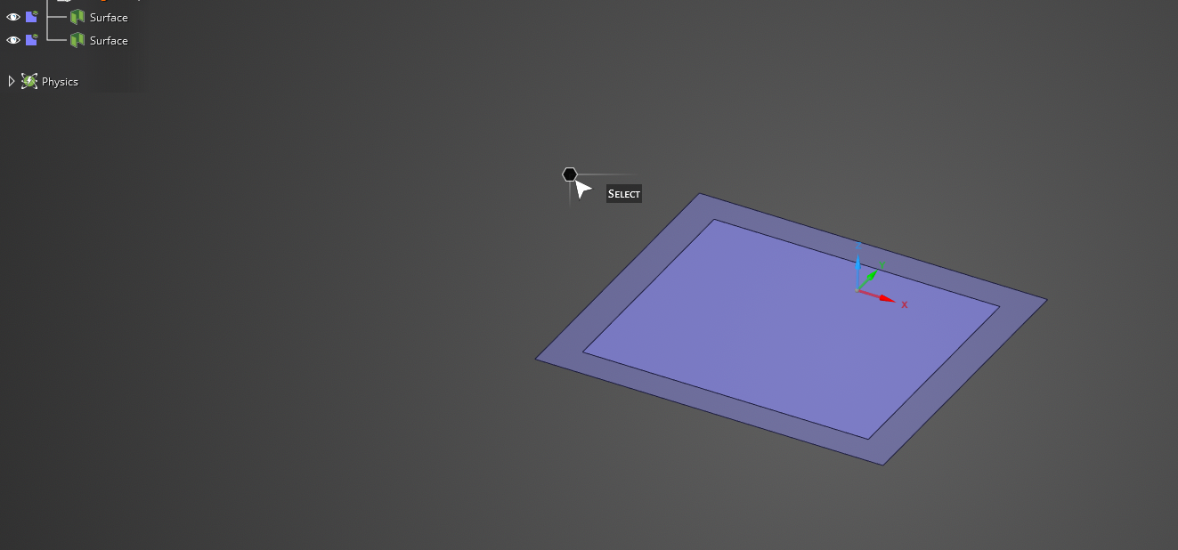

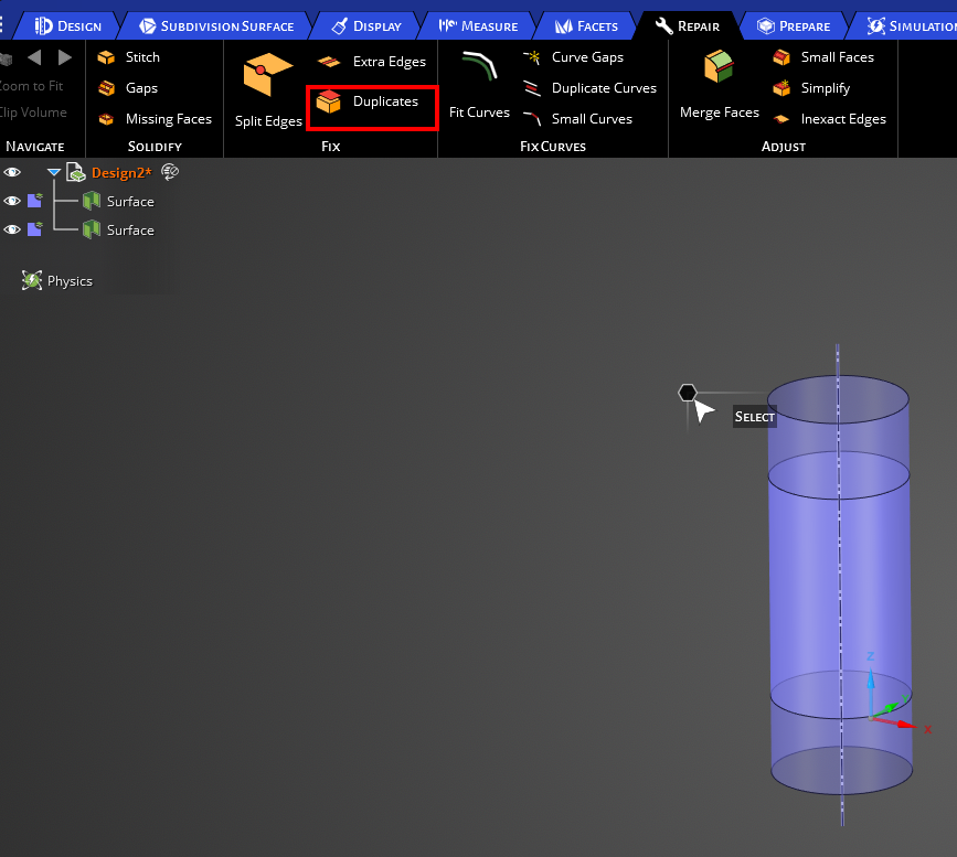

      Do you know how to detect duplicates faces ? I tried this tools but it works only on flat faces.
      Thanks,
    • Devendra Badgujar
      Hi GUICAD

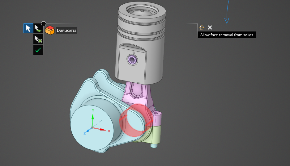

      The Duplicates tool automatically detects, highlights, and removes all duplicate faces on surfaces and from solids as well. Please check the attached image for your reference, it works with all duplicate faces. Regards.

      But if the surfaces are not exactly the same, is it possible to detect them ?
      • Devendra Badgujar
        GUICAD
         If the surfaces are not exactly same they won't be detected as duplicate faces, tool detects and fixes duplicate/identical faces.
