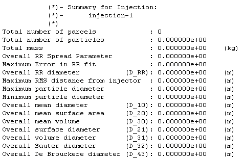

      I am using EWF and DPM for simulating annular flow. DPM for discrete droplet and continuous vapor phase whereas EWF for the liquid film. Here a surface injection on wall film which creates a loop over the faces adjacent to the wall is used by DEFINE_DPM_INJECTION_INIT macros for injecting droplets that are entrained from the liquid film. When I try to get a summary of this injection under the Discrete Phase, all the values are zero. Why is this happening and how can I get a summary for the injection defined by DEFINE_DPM_INJECTION_INIT macros?

      I created a single-point injection as your recommendation. But, I got zero film stripping rate and film DPM mass source rate for the default settings in the particle stripping model. I changed critical shear stress from 100 to 90, 80, but got the same results(no striping and DPM source rate). Why is this happening?
      When I used UDF entrainment correlation and created an injection from the wall by DEFINE_DPM_INJECTION_INIT macros, I got entrainment rate only. I got DPM mass source rate only when I created a second injection under DPM at the inlet and injected a fraction of liquid as droplets. What might be the reason for getting DPM mass source only when I have inlet injection and no DPM mass source for other cases?

      Still, it's showing no Film DPM mass source. What might be the reason? Does ANSYS really count Film DPM mass source for the injection defined by DEFINE_DPM_INJECTION_INIT macros? Because when I have a surface injection with fixed droplet mass flow rate at inlet ANSYS print info [ like injection N particle, escape n, absorbed n..] in the console window. But, for DEFINE_DPM_INJECTION_INIT , ANSYS shows no information in the console window.
