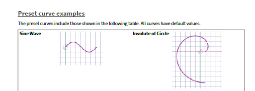

      The closest I found was this:

    • waetzold
      Hi Keyur
      This just the manual as website. How can use the preset curves? Especially the "Archimedes Spiral"?
      Flo
    • Keyur Kanade
      If you have parameters of the equation with you, the equation is constructed in the Options panel.  You can enter an equation in the input fields.
      If you want to create custom equation then please see custom equation in the help link provided.
