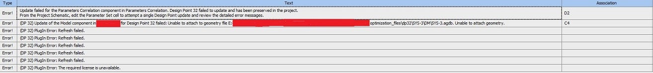

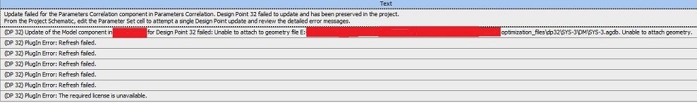

SubscriberI'm facing errors (image below) while updating certain design points using both Parameters Correlation and RSO within the Design Exploration toolbox.

Forum ModeratorWe're not permitted to open attachments, so please have another try.
If it's only certain design points, try and do the update manually. Typically errors occur when geometry gets twisted/changes topology (ie bits get chopped off) or the mesher can't cope with the new shape based on the previous settings.
February 23, 2022 at 12:43 pmFebruary 23, 2022 at 1:58 pmRob
Forum ModeratorWhat's different about the geometry?

February 23, 2022 at 7:42 pmWolfgangNeil
SubscriberI've created a new WB file with the same geometry. Right now I'm not getting any errors with geometry file attachment as per the screenshot I had shared earlier.
However, my observations are while performing the DOEs: -
1) For allowed value as "Any" for input parameters, the DOE is completed unhindered.
2) For allowed value as "Manufacturable" for input parameters, upon defining the distinct values, I'm getting an error for one DP for CCD type due to an un-converged solution.
Dimensions for failed DP: 793.5 x 345 x 1449 mm
Further, I've tried to solve the DP separately by importing this DP into the parameter set. However, it failed to solve.
# Mesh setting: Linear element order with sizing (hard behaviour) and multi-zone method.
