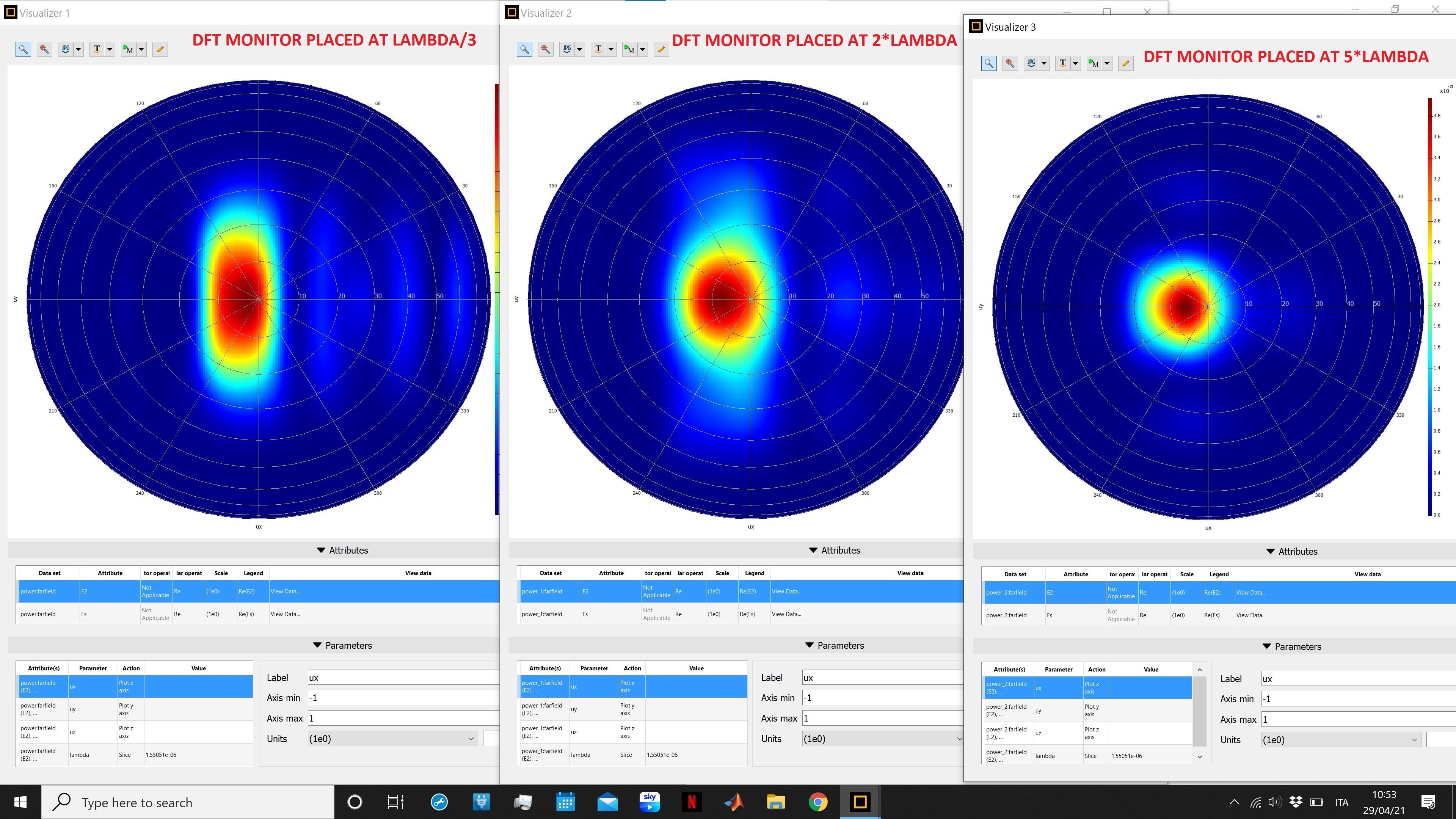

Generally, when using a DFT monitor for far field projections it is best to place the monitor as close as possible to the scattering object, with as large a span as possible. This allows the monitor to record the light propagating at as wide a range of angles as possible. It might be useful to expand the span of your simulation region as well, if this means you can make the monitor larger.
April 29, 2021 at 4:05 pmgabcavicchio
SubscriberThank you really much for your answer
April 29, 2021 at 10:45 pmKyle
Ansys EmployeeYou're welcome!
