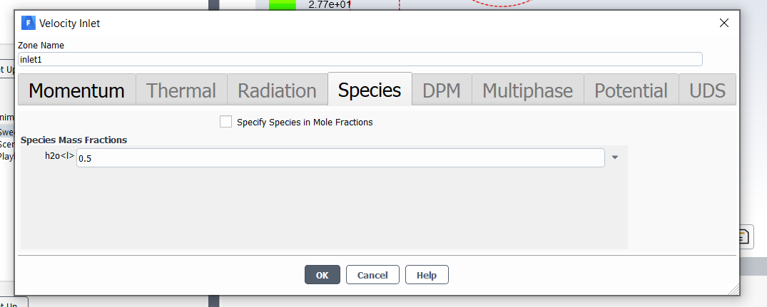

    • bsak723
      Hi Amine,
      When I look into both inlets, I can only find a mass fraction for one of the fluids, as shown below.  I want to have different fluids coming in from different inlets.  How am I supposed to accomplish that given I can only change one fluid mass fraction?
