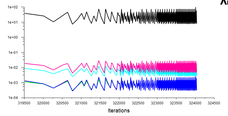

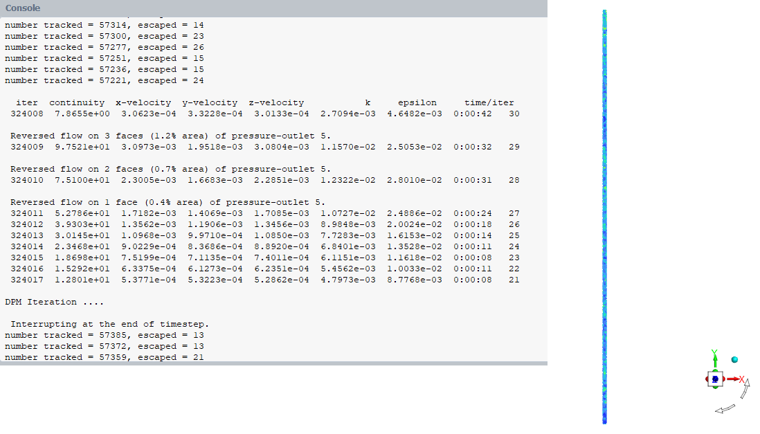

      Good morning,
      I have two questions about my simulation; I would appreciate it if you could help me solve them.
      1. Because my continuity equation does not converge, it did converge at the beginning, but after adding the particles, it stopped doing so. Should I reduce the timestep of the particles?
      2. After many iterations, when my particles reached the top of the vertical pipe, some results it shows "reverse flow", why?
      In my boundary conditions, I have placed that the pressure at the outlet is 0; also the velocity of the air in the inlet is 10m/s
      Thank you in advance for taking the time to help me solve my doubts.
      Have a look at why the flow is reversing before changing anything else.  Is there an explainable cause? What is the DPM condition set at the outlet? What is the outlet backflow condition, and how does that compare with the flow going out near there?
      Simulation is a tool, and you need to understand why something is happening rather than (always) worrying about the warnings. We use the warnings to focus our checks, but don't always correct them.

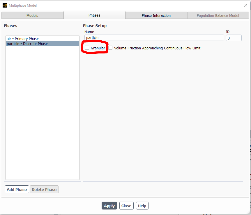

      Please allow me to ask you one last additional question:
      Having a simulation with a large volume fraction and I want to evaluate the collisions present, I would use the DDPM and DEM options. So my question is, under these conditions should I activate the Granular option offered by the DDPM? (I have read the manual, but I still have that doubt)
      Thanks!
      DEM is a pure collision model so volume fraction isn't checked. DDPM probably needs granular as the particles will spread out again based on the flow.
