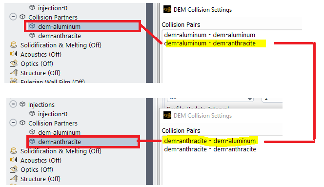

I am working on a horizontal pipe with air and solid particles; I intend to use a four-way coupled (gas-solid, solid-gas, particle-wall, particle-particle) Eulerian-Lagrangian under the DPM option.
For the collisions, I want to use the DEM collision model. When I open the DEM option, the Collision Partners option appears by default:
DEM-aluminum > dem-aluminum - dem-anthracite
DEM-anthracite > dem anthracite - aluminum
I must assume that I must fill both options with the same data since they reflect the same thing, right? (the collision of the particles with the wall of the pipe)Or is there a difference between those two options?Â

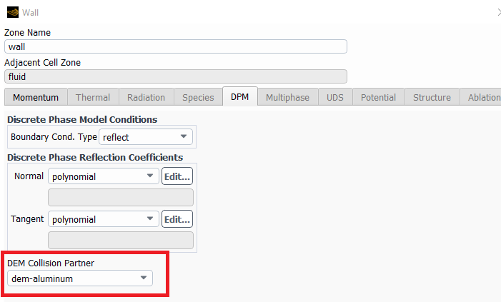

And how are there related to the wall boundary conditions? (in the option 'DEM Collision Partner')

Forum ModeratorThat's the same collision twice. You need one pair for particle & wall and a second pair for particle & particle. There may be a little trial and error, or my test case is corrupt due to being built in Fluent v6
To be honest, DEM in Fluent will cost you an awful lot of time because of the time steps needed to resolve the collisions. I'd favour Ansys Rocky coupled to Fluent, pure DPM or Eulerian over Fluent's DEM depending on need, particle loading and software availability.Â
The other properties are based on how the collisions behave, so may require experimental data.Â

SubscriberHello Rob, thank you very much for your answer; I only have the question if I should enter the information twice (for the same collision)?

Forum ModeratorIf you've managed to get the same collision twice delete it: I did say there may be some tinkering.Â
