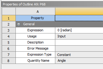

SubscriberI'm relatively new to Ansys products. I'm trying to do a parameter study using Spaceclaim and Workbench.
I created a couple geometry parameters in Spaceclaim. Then I deleted them, and recreated them with the same names. I did this a few times as I was building my model. Unfortunately, it seems that the Parameter Set in Workbench seems to remember the deleted parameters. How do I refresh Workbench so it only has the parameters that are currently in Spaceclaim?

SubscriberI found that if you go to the variable that you are using for the input parameter and then uncheck the "use as input parameter" checkbox, save the project, then go back and check the checkbox and it should clear up the unused parameter.
I also found that in the case where you delete an expression or variable that you used as an input parameter it will not delete it from the Workbench parameters list. To get around this, remake the variable that you deleted, i.e. if you deleted a variable, that we'll call X1, that was an input parameter, remake the variable X1 but this time don't check the "use as input parameter" checkbox, save the project, and it will be deleted from your parameter list in Workbench. Then you can go back and delete the variable again.
