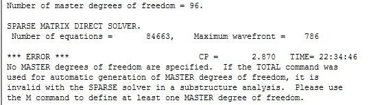

SubscriberI have a problem with calculating the stiffness matrix. Basically, I followed the instruction from the web, using the following codes, and have tried a relatively simple box design. In the end, I was able to get the matrix I needed.Â
But when it comes to my gearbox design, which is set 16 remote Points in the middle of the bearings and named in command, the same calculating way met some problems. Ansys reported the following error:
No MASTER degrees of freedom are specified. If the TOTAL command was used for automatic generation of MASTER degrees of freedom, it is invalid with the SPARSE solver in a substructure analysis. Please use the M command to define at least one MASTER degree of freedom.
This is a bit weird because as far as I know, I do use the M function in my code, which should specify the DOF. I expect a 96*96 stiffness matrix.

Ansys EmployeeIt sounds like somehow the M commands do not have valid node IDs specified. Add a *STAT command just before the DO loop like below to see if you have valid node ID numbers M1, M2, M3 etc. Also in the output see the response for "M" command. You can also add a MLIST at the end of the loop to see a list of Master DOFs.

For the error message there are 2 suggestions:
Please check if the remote point behavior is set "deformable", CMS won't recognize it as Master DOF and then give the error. To fix this change the behavior to "rigid" which uses MPC184 element and hence there is an element (MPC184) linked to the remote node not just some CE equations and then Master DOF would be recognized.
Another option is to create not only the single node but also the mass element type with a negligible mass.
