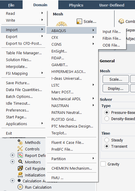

January 4, 2022 at 3:40 amKeyur Kanade
Ansys EmployeeFluent has following options.
For more info please check following link.
Chapter 3: Reading and Writing Files (ansys.com)
Regards Keyur
January 4, 2022 at 4:18 pmRob
Forum ModeratorIf it's only the solid shape that you need you may need to read it into SpaceClaim, then add the fluid region and then move onto Fluent Meshing. Check what SpaceClaim will read and go from there.
