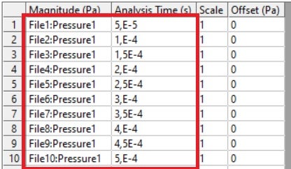

      I'm trying to conduct a transient structural analysis which I use external data for the pressure values on each node on the model and I have one csv file for each time step. After I imported every csv file, I need to define the time of every csv file in Transient Sturctural module. But since I have 10000 csv files and time steps, I couldn't find a way to define it in a proper way in Transient Structural Module -> Imported Load -> Imported Pressure -> Data View.
      In previous cases, when I had only 300 files, I was able to create the table in excel and just copy/paste was working. But now since there are 10000 rows to copy and paste, the program crashes.
      How can I achieve this? I would appreciate any help.

      This will fill in the rows in Mechanical but would be limited by any row limits the application may have. If that is the problem, the entire imported load would need to be done in APDL.
      impLoadGroup = ExtAPI.DataModel.GetObjectsByType(Ansys.ACT.Automation.Mechanical.ImportedLoads.ImportedLoadGroup)    # Submodeling folder is also this type
      impLoadFolder = impLoadGroup[0]   # first Imported Load folder
      impLoad = impLoadFolder.Children[0]    # to get first load under Imported Load folder if load already exists
      table = impLoad.GetTableByName("Data View")
      for i in range(1,11):
          row = Ansys.ACT.Automation.Mechanical.WorksheetRow()
          row.Item['Magnitude'] = 'File' + str(i) + ':Pressure1'
          row.Item['Analysis Time'] = 0.00005*i
          #row.Item['Scale'] = 1.0
          #row.Item['Offset'] = 0.0
          table.Add(row)
      ExtAPI.DataModel.Tree.Refresh()
      #impLoadFolder.ImportLoad()    # To generate load

        Overall, it is working. However I have a minor problem with it. The script skips the first fillable row and starts to fill the table on the second row. So if I run the script as "for i in range(2,11)", everything fits well and I can adjust the first row by clicking. But I couldn't understand what causes this.
        Also, when I run the script in the range of 11200 rows, the program doesn't respond again but meanwhile I'm trying to do it in parts by automatizing. I would appreciate if you can inform me how can I do the entire imported load in APDL.
        Thank you so much!
    • mjmiddle
      Mechanical aleady has a first row, and the script only adds rows. That would be why it skips the first row.

      The Transaction pauses update of the Outline objects, so it’s good for operations that create/edit the Outline many iterative times. Just place the repetitive code in an indented block under it. I also adjusted it to fill the first line:
      with Transaction():
          row1 = table.Item[0]
          row1.Item[‘Magnitude’] = ‘File1:Pressure1′
          row1.Item[‘Analysis Time’] = 0.00005
          for i in range(2,11):
              table.Add(row)
