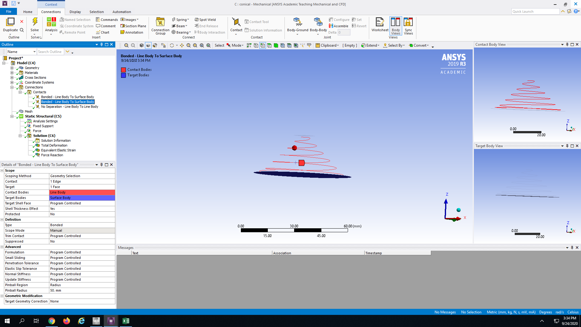

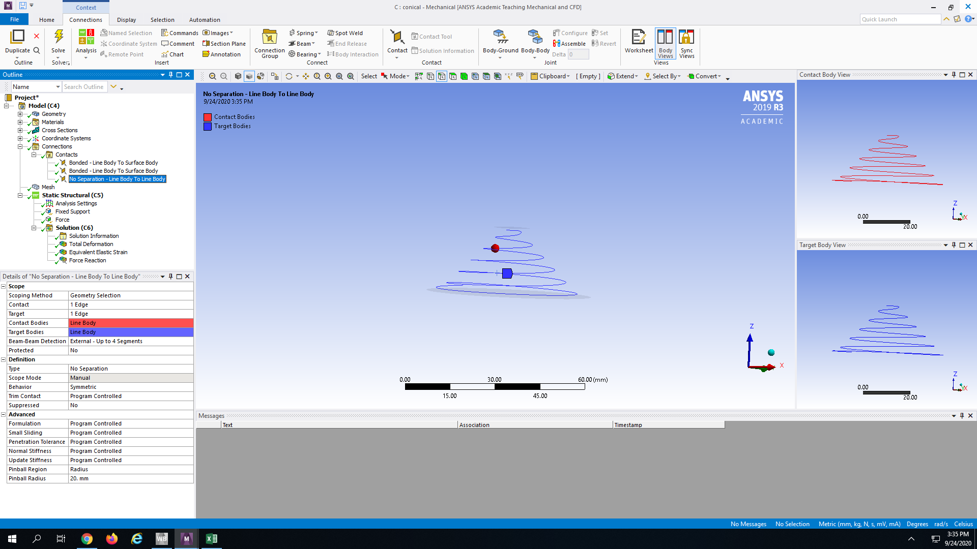

I am performing a Static Structural loading test but I am unable to enable self contact so that the body elements will not pass through each other.
September 24, 2020 at 8:11 pmpeteroznewman
SubscriberPlease set the Pinball Radius on the Contact of the Spring with itself to a large value. Insert (don't attach) a screen snap (not a cellphone photo) of the Contact definition and the Pinball in the Graphics window.nDo the same with the Contact of the Spring to the Top Plate.nDo the same with the Contact of the Spring to the Bottom Plate.nSeptember 24, 2020 at 8:38 pmharsh13295
SubscriberContact of the Spring to the Top Platen
Contact definition and the PinballnAs you suggested i took the pinball radius but still not able to solve Thank you @peteroznewman for helping men
September 25, 2020 at 2:02 ampeteroznewman
SubscriberAll three contacts should be Frictional. There should be a fixed support on the vertex at the bottom of the spring.nIf the bottom plate is a Fixed Support, the top plate should have a Remote Displacement that moves it in the -Z direction while keeping all other DOF at 0.nSeptember 25, 2020 at 9:20 pmharsh13295
SubscriberThank you for your help nIt is solve perfectly.nViewing 4 reply threads- The topic ‘Defining self contact in static structural in spring line body and plate?’ is closed to new replies.
