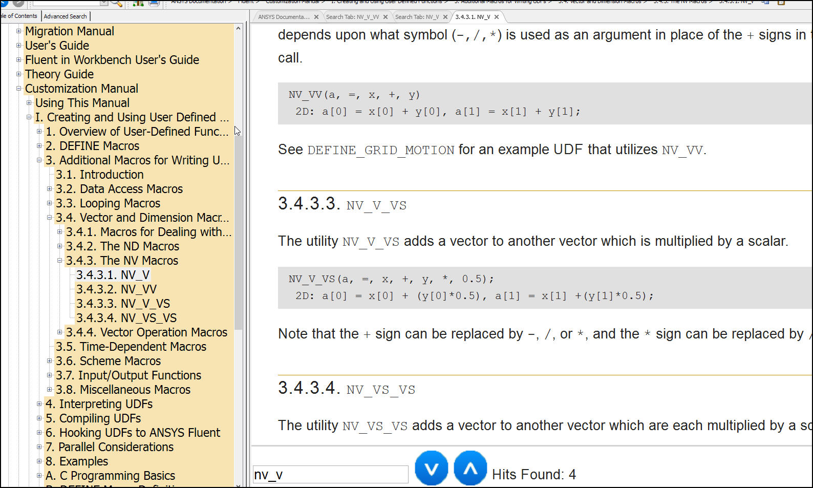

    • Keyur Kanade
      Please have a look at customization manual for NV macros.
