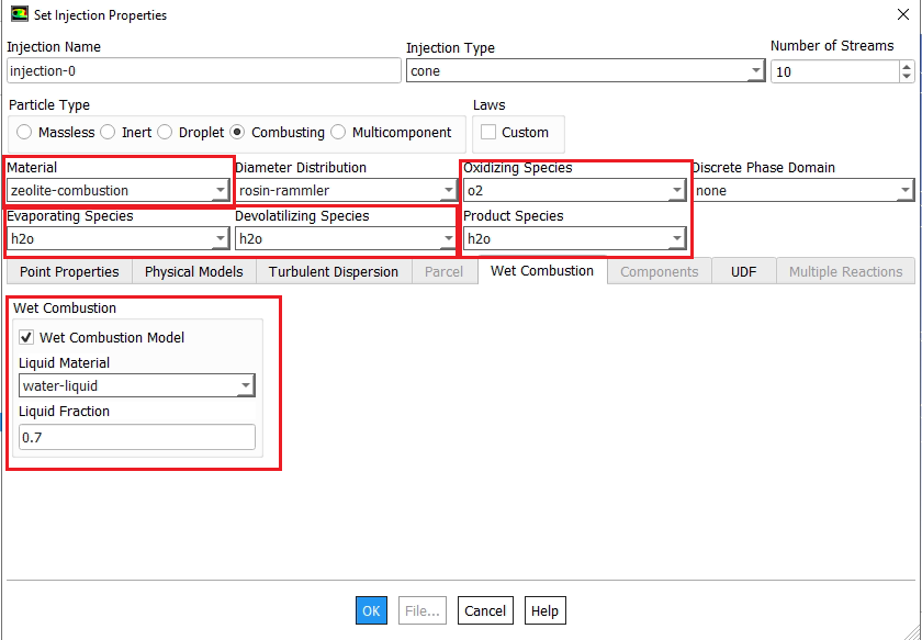

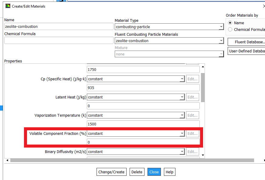

May 7, 2021 at 3:57 pmlizardxy
SubscriberThank you for the suggestion and I am now giving a try. What I model is a zeolite-water suspension with 70% water.
After setting the option "Combusting" as the particle type, I defined the zeolite as shown in the 1st screenshot. Is the volatile component fraction of zero a right definition?
In the 2nd screenshot, I am not sure if I've defined the right materials in the red frames. Besides I turn on the "Wet Combustion" option and set the water as 70% liquid fraction.
Could you please have a look and check if I set everything right here?
May 7, 2021 at 4:00 pmRob
Forum ModeratorI think so, it's been a while since I last abused the model in that way: I was modelling inhalers with the drug being carried in a carrier fluid of some sort. Try it and see what happens.
