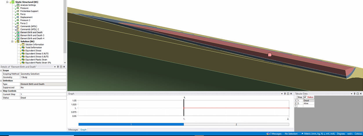

      I try to use the inbuilt element birth and death functionality in Ansys mechanical enterprise to kill the elements of two different bodies in two timestep operation but couldn't. It seems not more than one analysis (either to kill the element or make them alive) can be performed on the current time step. When I try to include another element birth and death functionality, it will capture the same time step that was put in earlier, and hence wouldn't run on a second time step. Please see figures below to illustrate this better.
      I try performing element death on the highlighted portion in the first time step as shown below. But when I try performing another element death operation on the next portion (underneath) and changed the current step to 2, the first one I previously set was also changed to 2. As such, I am not able to perform separate death operation on the two time steps for the two portions. Can you please suggest what I can do to enable me perform this operation for these portions using the two different time-steps.

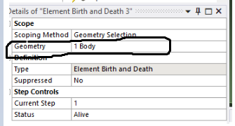

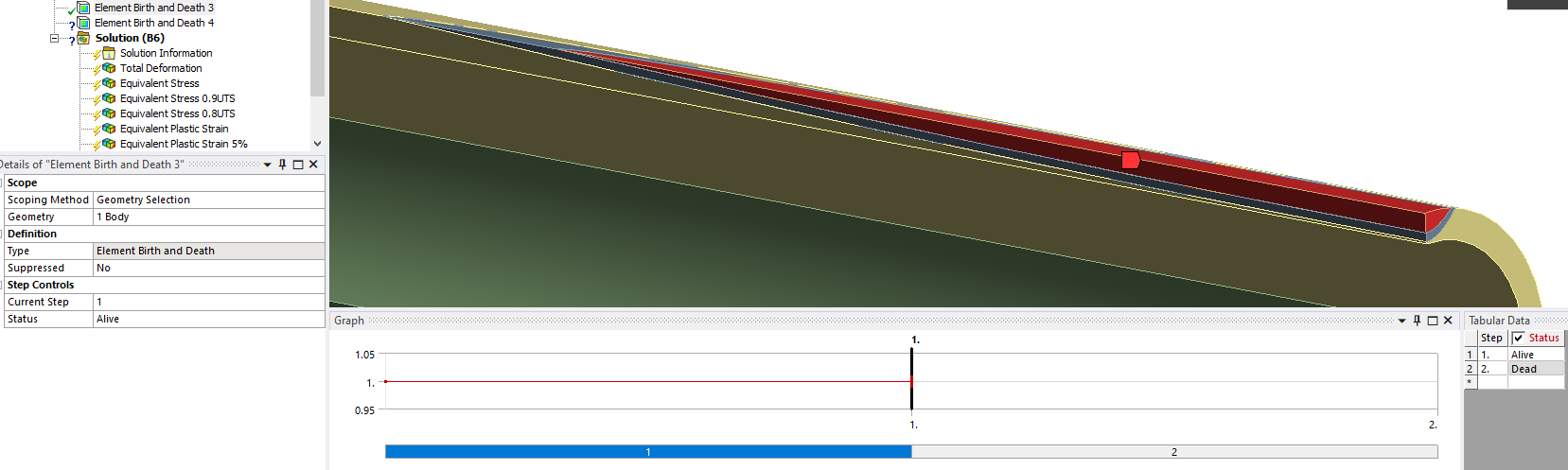

      Thanks @briveal. Yes, I have done so as show below in the figure. But I still need to kill the elements in the subsequent body (i.e., the body underneath the red highlighted one) using the 2nd step. I tried creating a new case for it but didn't run successfully. My question is how can I perform the element death of these two separate bodies using two different current steps?
    • Emperor
      in the geometry part of detail of "element Birth and Death 3" you can select the number of bodies that will die. In your case there is only one body selected

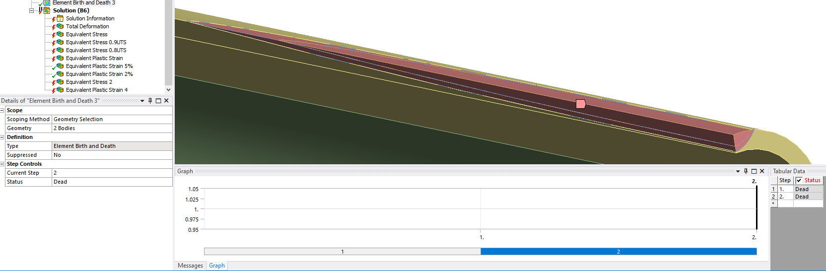

    • Emperor
      in step 2, you have to select both bodies (dead), because if you only select body 2 in step 2, it will bring body 1 back to life I think and in my opinion you will have boundary condition problems.
    • Ifexco
      ,I have done this, yet still had the errors after running it. What more can I do?
