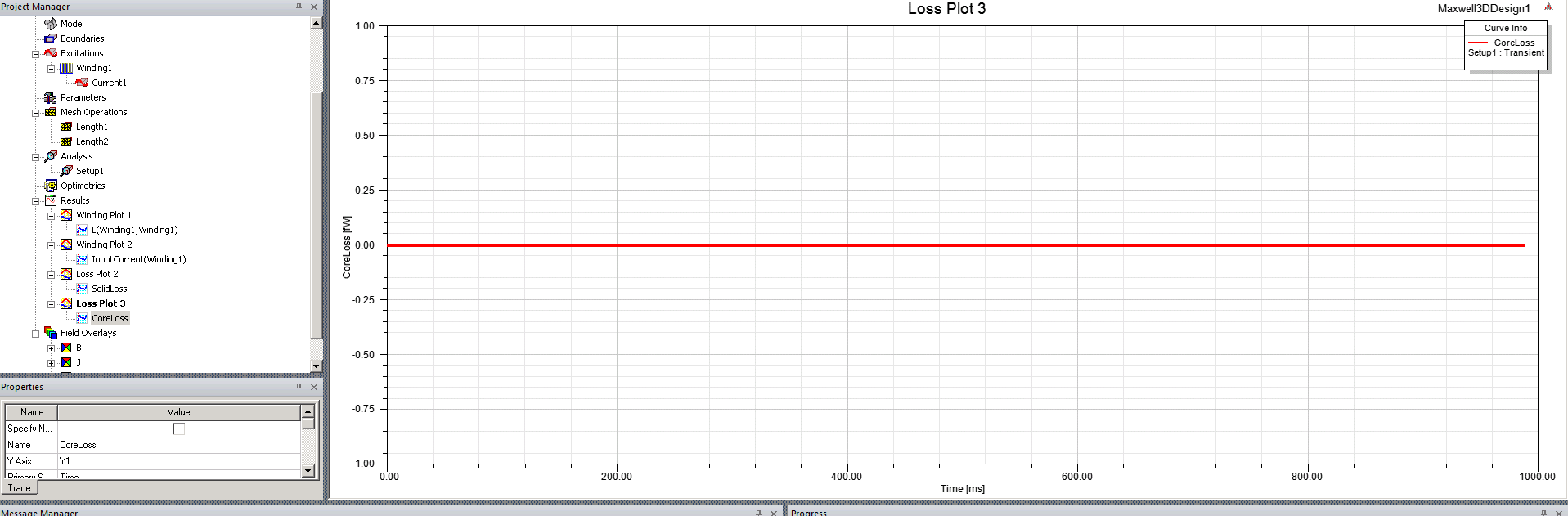

March 23, 2021 at 12:12 pm
Isha_Engg
SubscriberHello,I try to calculate the core loss, but I get zero core loss. What could be the problem in the simulation? I also generated a correct meshing. nCore loss graph is given as zero:n
There is also a parameter Solid loss. What is this loss?nRegards,Ishanin
March 23, 2021 at 6:27 pm
icellb1
Ansys EmployeeHi,nYou can check whether you set core loss calculation by right clicking excitation tab-->set core loss, and then tick the object on which you want to calculate core loss. Solid loss represents the resistive loss of solid conductors, it's calculated on conductors with set eddy effect on or related to a solid type winding or conductor.n -
March 24, 2021 at 5:37 am
Isha_Engg
SubscriberHello, nI had already set the core loss but I still dont get the results. How is solid loss different from ohmic loss?nRegardsn
