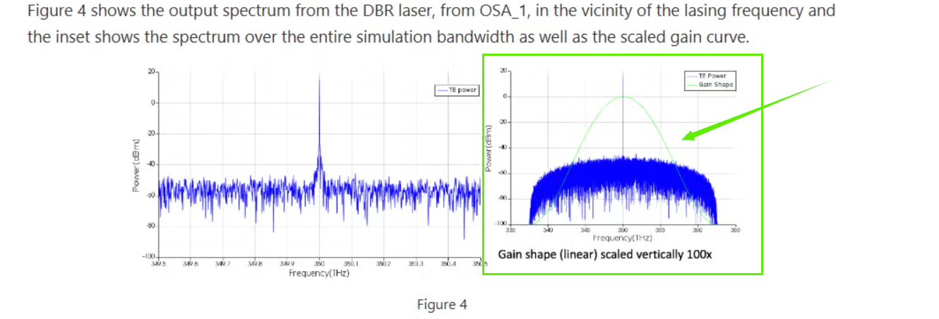

      Follow the steps, I don't know how to get the scaled gain curve as shown in the figure above, dear engineer, Could you give me some guidance? Thank you very much!

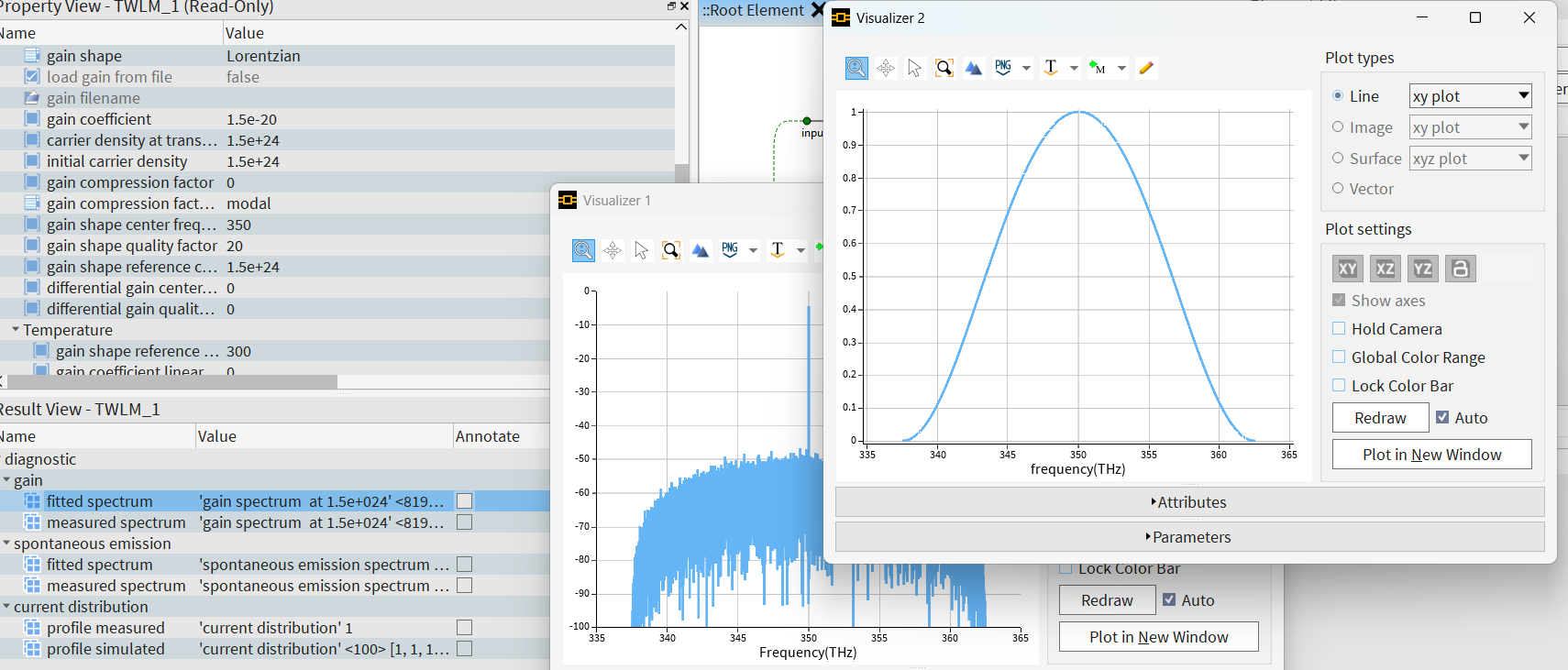

    • wangyizhe
      Dear engineer, I'm not sure if you need this screenshot?
    • GWANG
      Hi wangyizhe,
      Please let us know which gain curve do you try to get? From the plots it looks like you can generate the gain curve, do you just want to plot them on top of each other?
    • wangyizhe
      Yes, I'd like to achieve the effect shown in the picture
    • GWANG
      Hi wangyizhe,
      You can plot either figure first, then try to right click on the other result entry, and select "add to visualizer..." and choose the corresponding visualizer to add the plot to.
