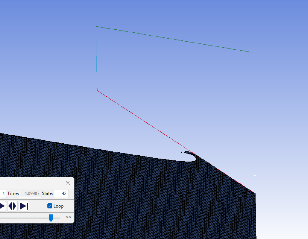

      I'm analysing the impact of a BEAM element with MAT_ELASTIC on the water.

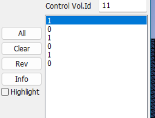

      I need the local pression in different points of the body. I've definied with DATABASE_FSI several different points but importing the .dbfsi results file in post processing I get the same plot for all the points.
      The odd points I've defined don't plot any results, just a straight line at 0.
      What I'm doing wrong? Is there another keyword to define?

      I want to evaluate the local stresses on the hull for the thickness sizing.
      I used the 2D model with S-ALE formulation, the bottom of the hull is definied as MAT_ELASTIC and the other two beams with a MAT_RIGID, same properties.
      I need to get the local pressure on the bottom of the hull with different angles and velocities.
      Water and air are definied with EOS_LINEAR_POLYNOMIAL and MAT_NULL.
