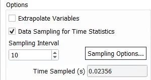

I run a transient simulation in Fluent with:
- Time step size: 1e-5 s
- Number of time steps: 50000
Results are saved every 100 steps.
After 0.1 s I turn on "Data sampling for Time statistics" option with" sampling interval" of 5. Then at 0.2 s I set the "sampling Interval" to 10. The calculation was interrupted at 0.3 s, I have loaded .dat file saved before and continued the simulations. However when I see the "Time Sampled", the value is 0.02356 as shown in Figure below ( I thouth it shoud be larger than 0.2 s).

SubscriberHello, The time sampled is only for the current run of the simulation. So, this run has only solved 0.02356s.
