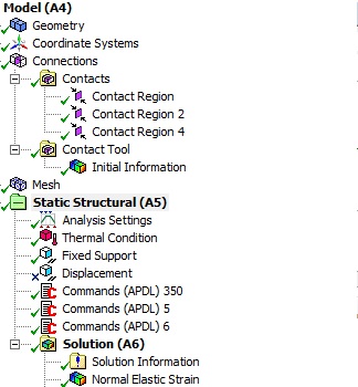

      I have a four layered structure on to which I have to apply a prestrain value at 350K and then I have to cool it to 300K and then to 77K.

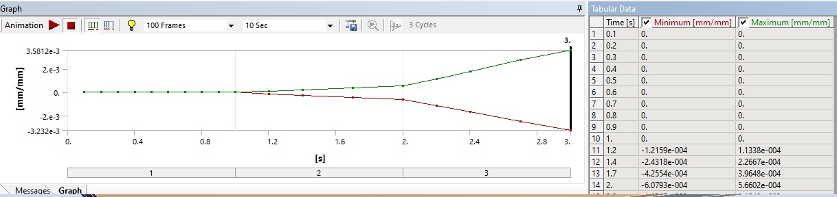

      So when I applied the prestrain value and tried to solve, the solver doesn’t converge. I thought it might be due to the initial prestrain value Iam giving. So what I did was I tried to give the prestrain value to the materials after making the contact pair kill in the first step. Then on the second step I made the contact alive. The solver solved the problem. But the issue is in the result. I cannot see the prestrain value in the initial step.
      the prestrain value given was
      inis,set,csys,-1
      inis,set,dtype,epel
      inis,set,mat,1
      inis,defi,,,,,2.4455e-3,1.9427e-3,-2.2588e-3,2.4455e-3,1.9427e-3,-2.2588e-3,2.4455e-3,1.9427e-3,-2.2588e-3
      inis,set,mat,2
      inis,defi,,,,,2.064e-5,1.2734e-5,-1.4897e-5,2.064e-5,1.2734e-5,-1.4897e-5,2.064e-5,1.2734e-5,-1.4897e-5
      inis,set,mat,3
      inis,defi,,,,,-1.4764e-3,-9.1691e-4,1.0269e-3,-1.4764e-3,-9.1691e-4,1.0269e-3,-1.4764e-3,-9.1691e-4,1.0269e-3
      inis,set,mat,4
      inis,defi,,,,,2.6127e-3,2.0345e-3,-2.3917e-3,2.6127e-3,2.0345e-3,-2.3917e-3,2.6127e-3,2.0345e-3,-2.3917e-3
      The kill and birth command I given was
      esel,s,type,gcn,
      ekill, all
      allsel
      esel,s,type,gcn,
      ealive, all
      allsel
