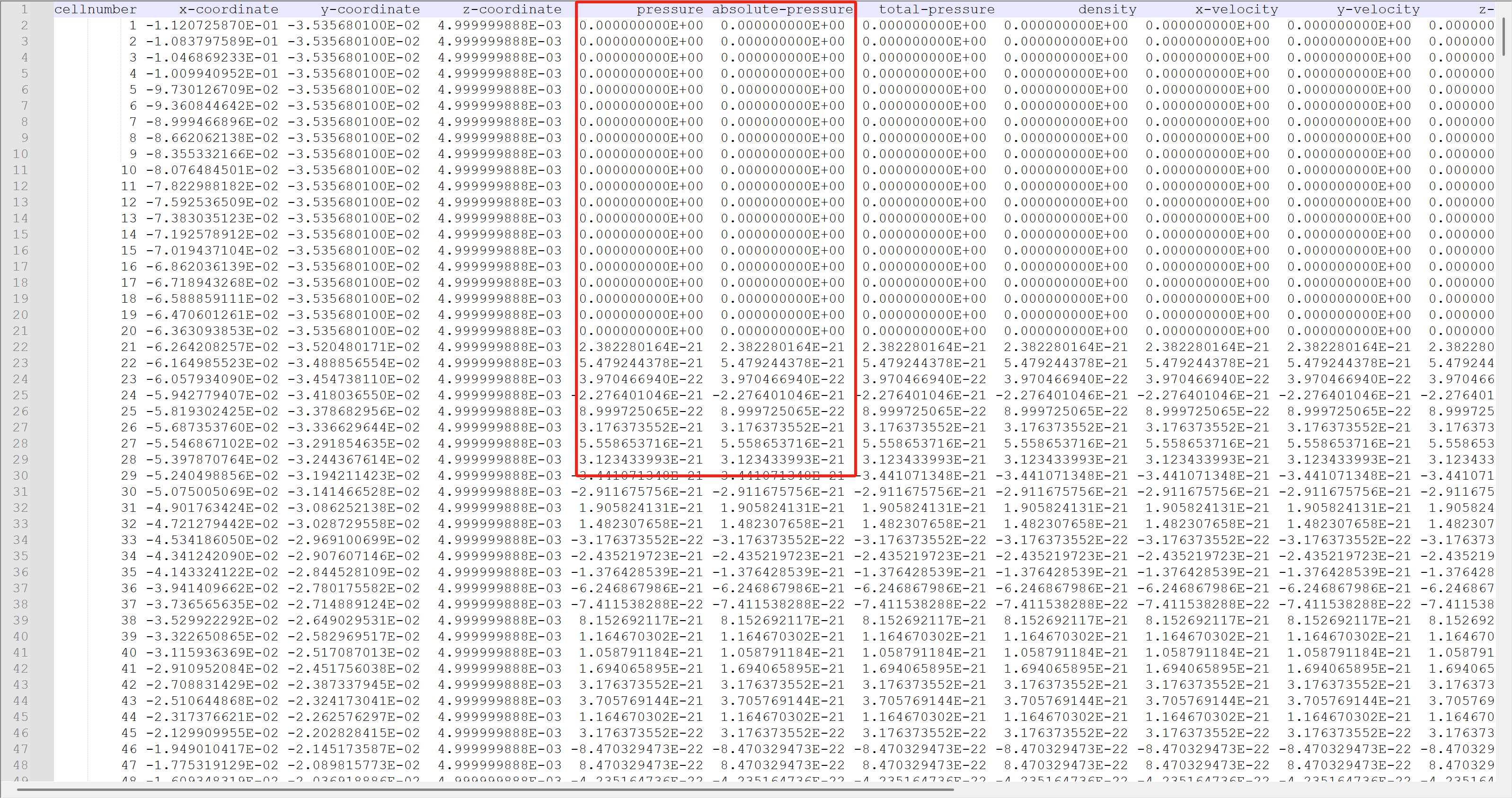

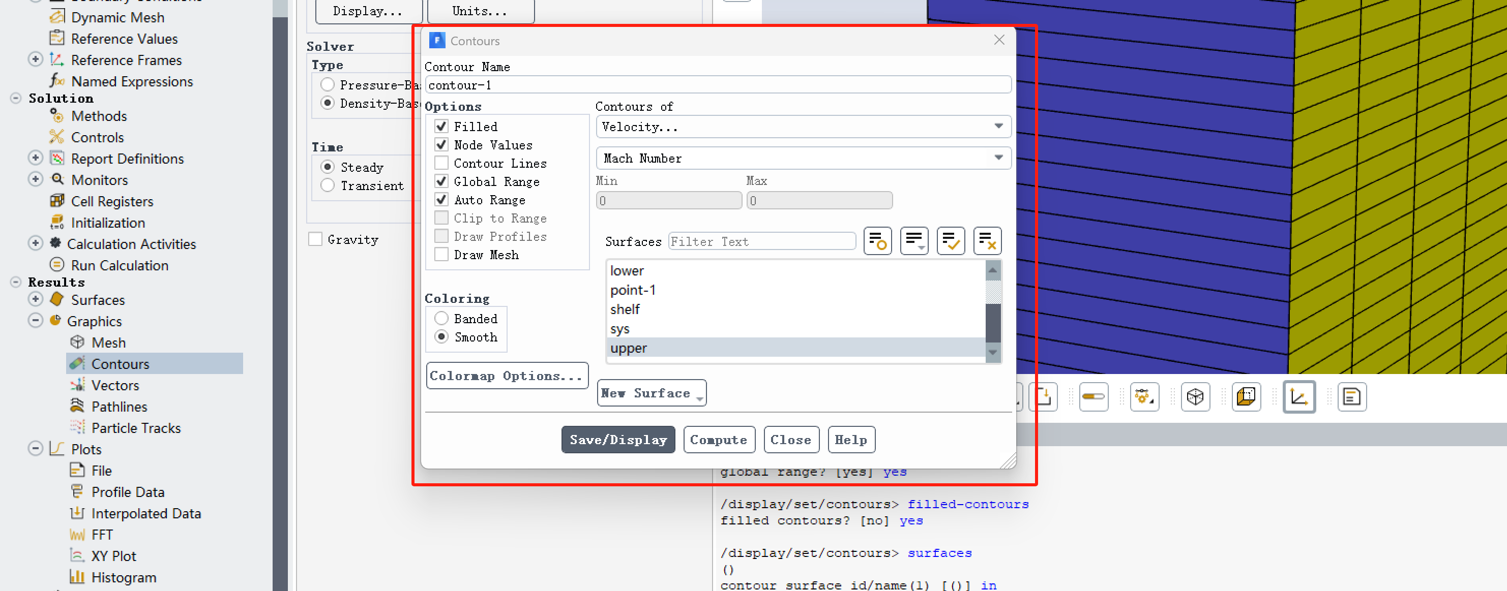

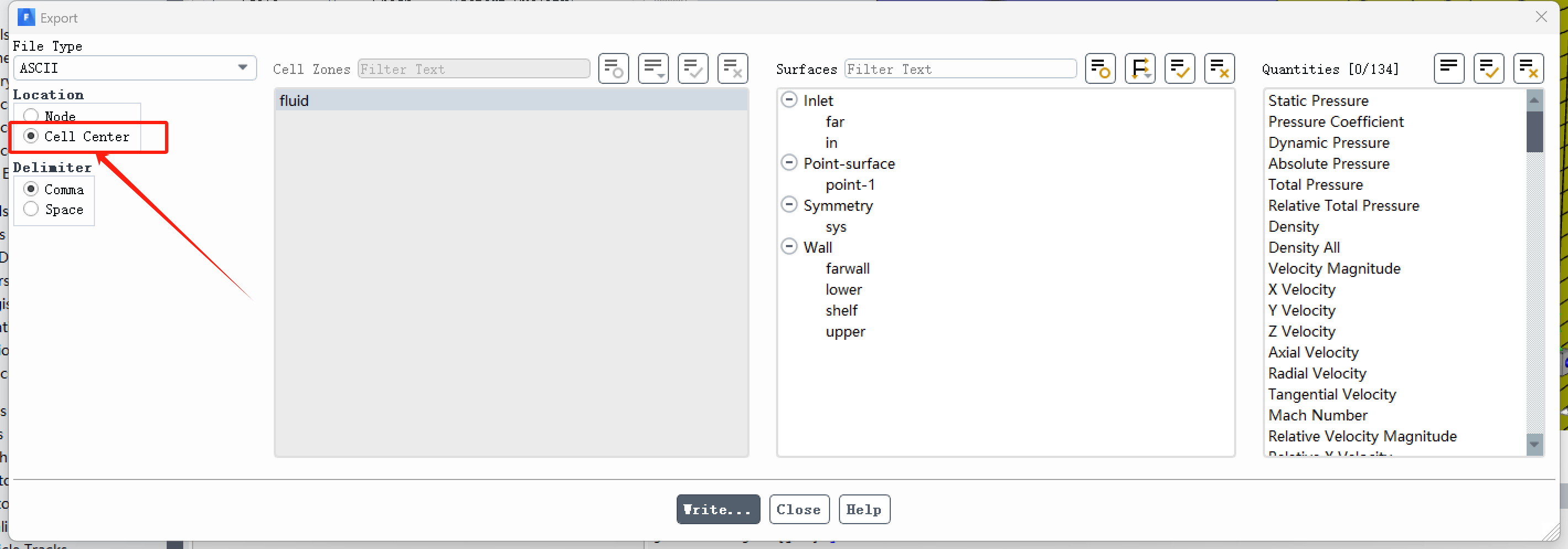

      When I want to export the data at the center of the grid points, I must first display the corresponding boundary contours, and then I can export the valid values. Otherwise, the values of the exported flow field variables will be 0.
