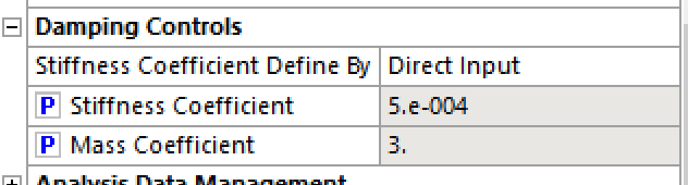

amando.gallardo
SubscriberMeans it is a "Paramateric" value, you can make an study with different values for those variables
https://www.youtube.com/watch?v=wYdtzh76j5w
December 2, 2022 at 12:31 pm
bhagwantP
Ansys EmployeeP stands for Paramateriztion in ansys.
Additional resourses:
How to Setup Parameters in Ansys Mechanical - YouTube
Parameterization with ANSYS Workbench - YouTube
Thanks
