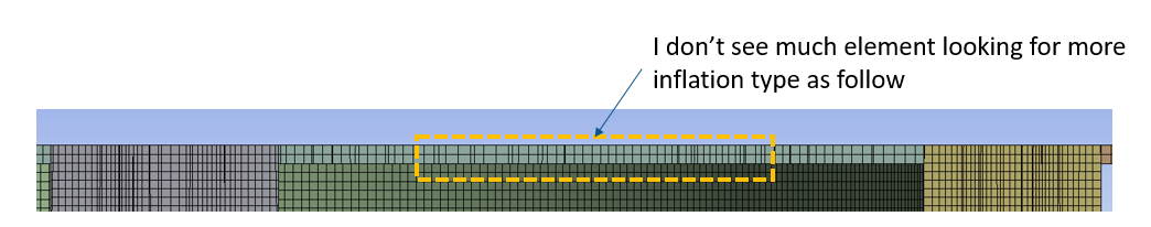

SubscriberThanks rob, I tried to breakdown the geometry as much as possible or the smallest entity and look that now most of the body is sweepable and hope it form more cylindrical surface and better meshing. One thing is that when I take sectionol view, I dont see much element in the think section part since it is my boundary, i thought to use the inflation but I cannot able to use the inflation tab under swept method. Any suggestion on that
December 14, 2022 at 2:49 pm
Rob
Forum ModeratorSweep and inflation interact differently to tet & inflation. With narrow gaps you may find proximity size function to be more useful.Â

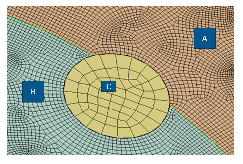

@Rob, I tried to enabled the proximity function but then I found some non-conforming issue at the mesh around it. The thing is whenever I make the cad model in the spaceclaim i choose the share topology to none, if I choose the share topology to merge or share, the mesh becoming conforming but then one of the body becomes the non-sweepable and we cannot use the hex mesh for that part. I think hex mesh is quite stucture mesh I can get for my application. You can see fluid domain A and C are not conforming both have separate pattern for the meshing element. In fact, I tried to match them by creating less number of division on the A side and they look as this below which is closest I can get. Later I tried to check the pressure contours it was just showing diffusion toward B side only there was no diffusion on A side.Â
December 15, 2022 at 5:18 pm
Rob
Forum ModeratorYou may need to set a source/target for the swept mesh, it's possible the tool is trying to sweep in a different direction to what you think it is. Share Topo is usually a good idea for CFD models, in the above you need to refine the yellow volume mesh as it's far too coarse even with a non-conformal interface.Â

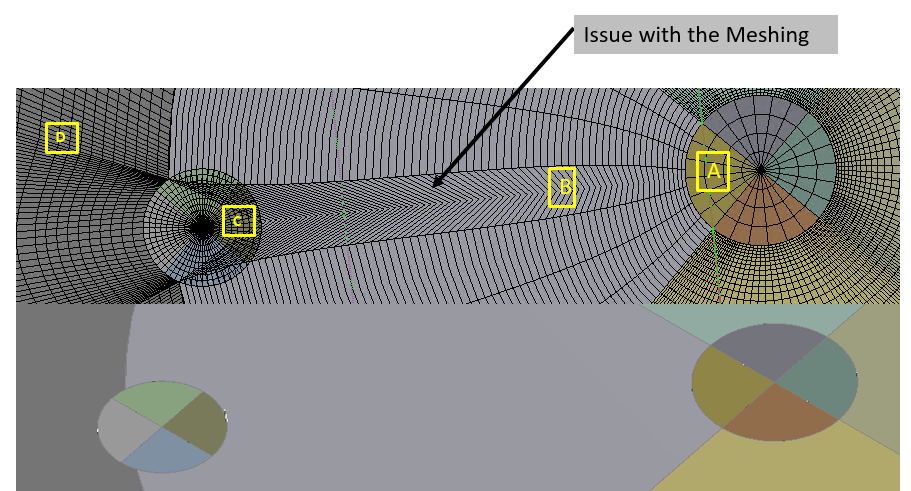

Case 1: Thanks I think tried to do that, I got this type of mesh. I am not sure what to do ahead. I have attached top view of the mesh and geometrical drawing too. Not sure how to remove the destortation between the source and sink circle.Â
B Case 2:
I thought to break the problem more into the curve I still see some mesh still haveorthogonality issue. any suggestion on that I just use the edge and sweep in the mesh for the below one. I also use the curvature one.
January 3, 2023 at 2:46 pm
Rob
Forum ModeratorOK, part of the problem is the surface mesh. There's an option to force a pave (ie not mapped) surface mesh and that'll help here.Â
