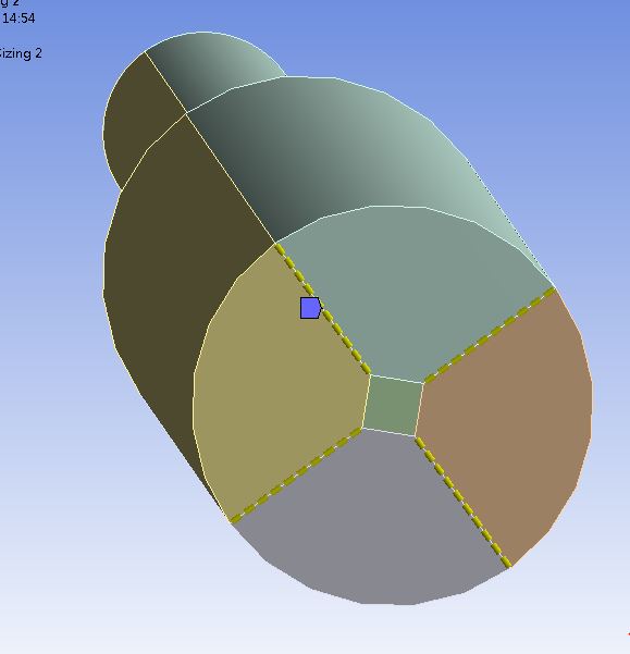

      hi everyone,i am ansys begginer.
      i reference many similar tutorial about cylinder.
      but my mesh quality always bad.
      if any one can give me some suggestion

    • HsuHung
      i split volume into five body and my setting in the below picture.
      then my min element quality and max skewness value is terrible
      can suggest me what setting more suitable this case
    • Aniket
      1. I would use either sweep or multizone not hex dominant
      2. I would split the bodies as shown in image below with red lines:

    • HsuHung
      i split like you suggestion and that can't successful .
      Then,i split like the below video but i can't use multizone  like it.

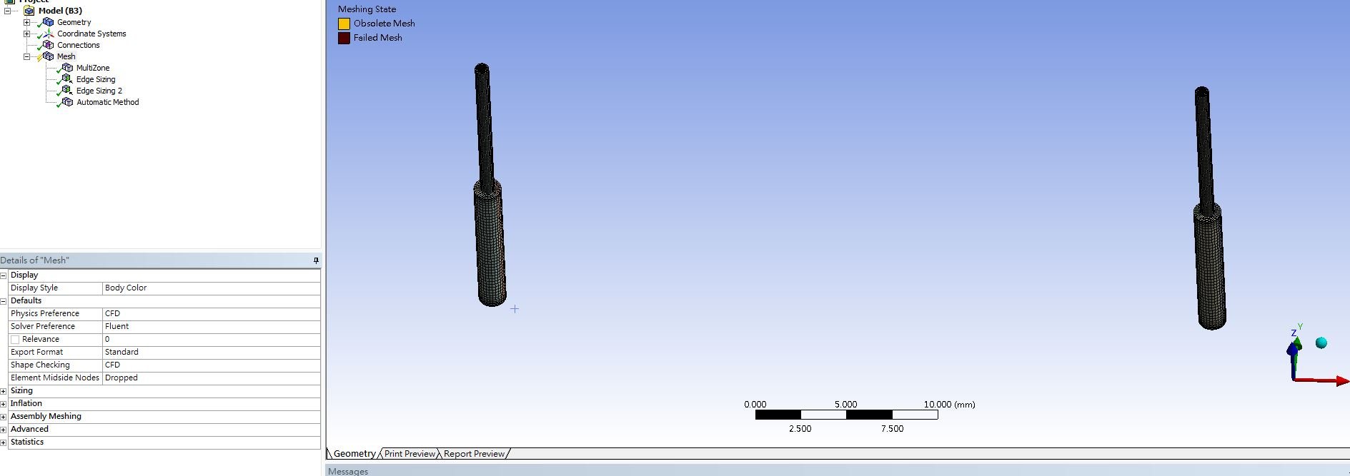

    • HsuHung
      1, I split body into 11 part and open share to topology.
      2. i use multizone and select two cylinder
      3. use edge size:number of division
      Then,mesh it but the bottom plate can't mesh
      The error information attach below

      I recommend you change the shape of the flat part at the bottom so it is not tangent to the large cylinder that is above it. That spike shape on the surface inevitably leads to poor element shapes or meshing problems as you can see. I recommend you move the end of the flat a short distance to the left to eliminate the tangent condition and do the same at the other end.

    • Aniket
      Instead of using Multizone try with the Sweep method and see if that helps.
      and As peteroznewman mentioned, we are not allowed to download files. so can't work on your actual model, but can only give suggestions.
      To get rid of the worst quality elements in the bottom part, you will need to either refine the mesh a lot or get rid of the almost tangency as Peter has mentioned. For the OGrid that you are cutting, I would use it as a last resort if default mesh with the sweep is too bad. I would first check the strategy that I mentioned in my first response. You can cut the bodies using cylindrical faces and arbitrary planes, right? Note I am not asking to split face using lines, I am asking to split bodies using surfaces.
