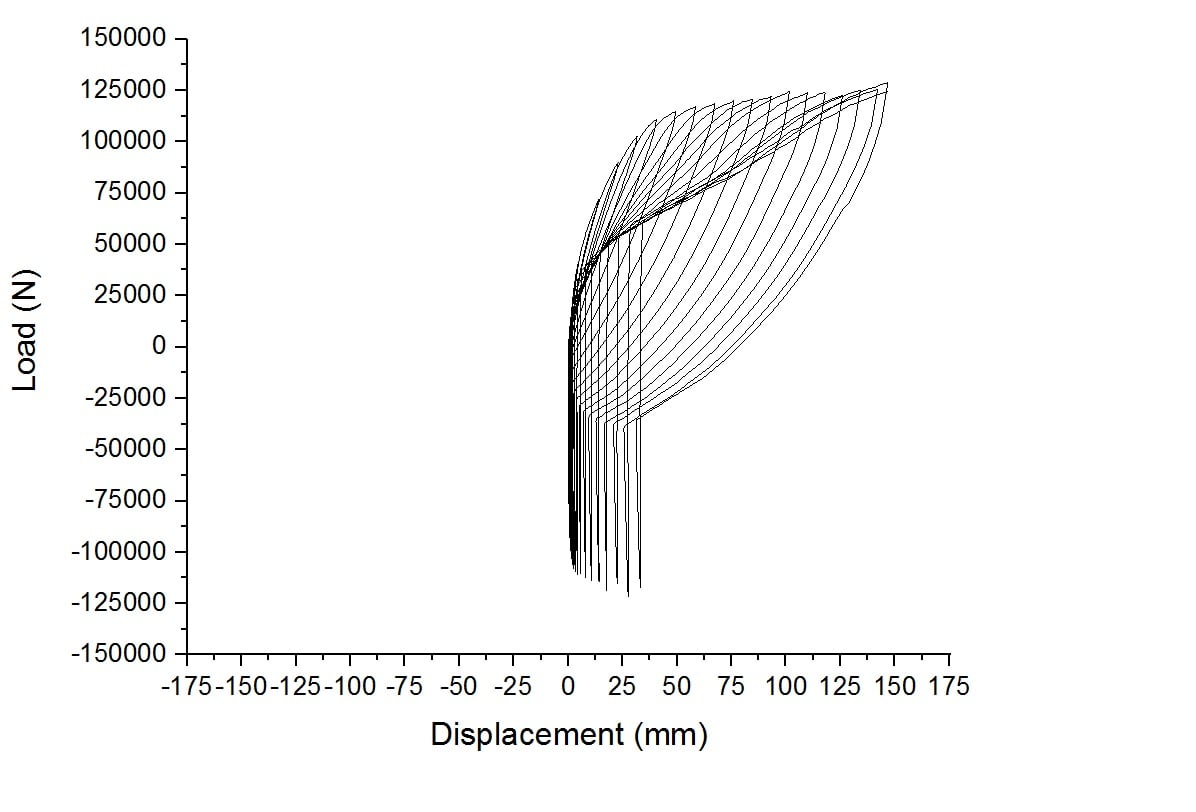

      I did a nonlinear analysis under monotonic cyclic loading, the force displacement curve is obtained. As you can see the negative part is not similar to the positive one. I would like to know how can I fix this problem?
      Is the result you output Displacement?  That is always positive.
      You need to output Directional Displacement which can go negative, but it is only tracking one axis. You might need two Directional Displacements if the point you are tracking does not travel along a straight line.  If the straight line is tracked, but just not one of the Global directions, you can make a rotated coordinate system and request Directional Displacement along one of the axes of that rotated coordinate system.

      @Peter Hi again, I create another coordinate system and rotate it (the attached file contains the model) but the obtained results are not correct. I hope you can check the file for any errors
    • Amin
      Hi Peter, I have succeeded to obtain the cyclic load. But I see from the curve obtained that the positive part is similar to the negative part (figure below). Is there a way to include the stiffness degradation in the curve (I mean when the cracks start a degradation in the stiffness will appear). How can I include this degradation in concrete.
      Hi Amin, I'm not the expert in concrete, so I will let other members comment on your question, like jj77, who has more experience with concrete models.

    • jj77
      Not much in ansys unfortunately it is what ever I see  and learn from here .
    • Amin
      Thank you jj77 for your reply, until now I didn't find anythings about stiffness degradation of concrete. Hope that any one can help

      Hi Amin Did you fond any way to modify the unloading branch in you hysteresis? I am modeling the seismic response of shear walls in APDL and I am facing the same problem
    • abdalla
      Dear AllnI think to consider concrete stiffness degradation during cyclic loading, it must be use Mender concrete model as APDL commands and also define the bond slip interaction between steel bars & concrete (NOT full tied )n
    • Dr. / Abdalla Mohamed
      To account cyclic degradtion , you need to adjust shear reduction coef. in Solid 65 model command
