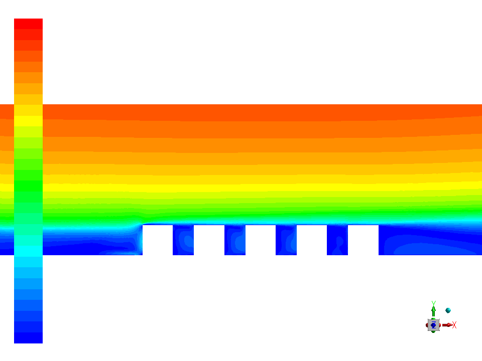

I simulated a case of fluid flow on an HPC cluster using Ansys Fluent 19.2 in batch mode. The simulation worked fine and since I did not have enough RAM to read the data file for post processing, I'm trying to save images of my contours remotely using TUI commands. So I use this shell command to run fluent to have graphics enabled:
fluent 3ddp -gu -t16 -mpi=openmpi -i &Name.jou >& out_$Name.log
then I use these TUI commands to define a contour and then save an image of it:
;---Display settings
/display/views/read-views "Views"
/display/set/contours/auto-range? yes
/display/set/contours/clip-to-range? no
/display/set/contours/filled-contours? yes
/display/set/contours/global-range? no
/display/set/contours/n-contour 30
/display/set/contours/node-values? yes
/display/set/lights/headlight-on? no
/display/set/lights/lights-on? no
/display/set/picture/color-mode/color
/display/set/picture/driver/png
/display/set/picture/x-resolution 960
/display/set/picture/y-resolution 720
;---Defining contour surfaces
/surface/plane z0plane 0 0 0 0 1 0 1 0 0
;---Saving contours
/display/set/contours/surfaces z0plane ()
/display/contour velocity-magnitude 3 8
/display/views/restore-view xplus-view
/display/save-picture "z0plane_V.png"
And all of them work fine except that the saved contour does not have any labels on its colormap(!!!), no numbers.
I tried to use
/display/set/color-map
menu, but it seems like that only changes the colors of the contours.How to fix this?
Thanks❤️
March 15, 2022 at 2:07 pmRob
Forum ModeratorPlease can you post one of the images? I wonder if you've got white text on a white background.
March 15, 2022 at 3:30 pmMarch 15, 2022 at 4:28 pmRob
Forum Moderatorcan you add
/preferences/appearance/gfc 255 0 0
at the beginning of the above and see what you get? We moved the foreground/background options into Preferences and I wonder if that's causing a problem here. I don't have R19.2 installed so can't check here.
March 15, 2022 at 4:55 pmAmine Ben Hadj Ali
Ansys EmployeeCan you move to a newer version and also try using Contour Objects.
March 15, 2022 at 11:46 pmm.shafiee1374
SubscriberHello and thanks for your responses Using contour objects worked.March 16, 2022 at 6:29 amAmine Ben Hadj Ali
Ansys EmployeeSuper! Welcome!
