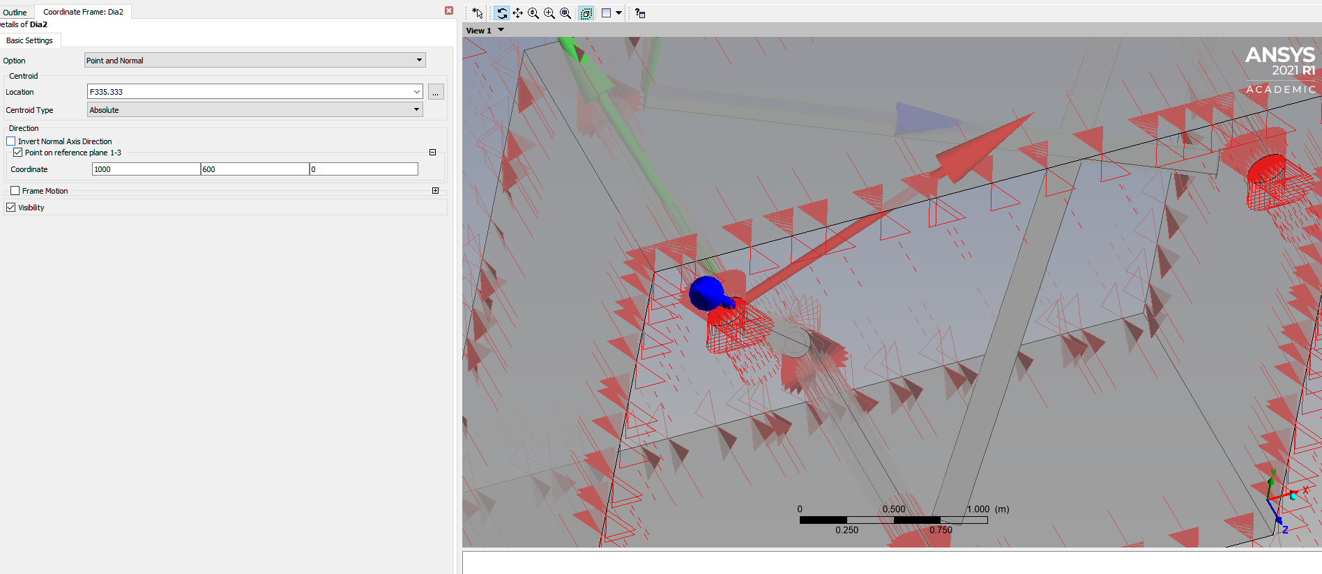

      I need the x-axis of my custom coordiante System to be parallel to the X-Y-plane, but I don't understand the notation that CFX is using.
      Can somebody tell me what numbers I have to enter?
      I created the coordiante System with the face on top of the cylinder and then tried different numbers to rotate it.
    • rfblumen
      See 27.2.1.1. Point and Normal in the CFX-Pre User's Guide. Using the "Point and Normal" , "Location" refers to a face in the model. The origin will be at the centroid of that face with the local z axis point normal to that face. Setting a set of coordinates under Coordinate will determine the orientation of the local x axis with respect to the local z axis.
      The local x-y plane will not be parallel to the global x-y plane due to orientation of the face normal. Similarly, it won't be possible to have the local x-axis be parallel to the global z-axis. To do this, use the "Axis Points" option instead of "Point and Normal" and do the following to set up the local coordinate frame:
      -Determine the coordinates of the current local coordinate frame. To do this, read the .cfx file into CFD-Post and calculate the centroid coordinates by getting the area-averaged (x,y,z) on the face used in CFX-Pre for the local coordinate frame. Specify the origin in the "Axis Points" method using these coordinates
      -For the "Z Axis Point", enter the origin coordinates and then perturb the z coordinate in the positive z direction
      -For the "X-Z Plane Point", enter the origin coordinates and perturb the x coordinate in the positive x direction
