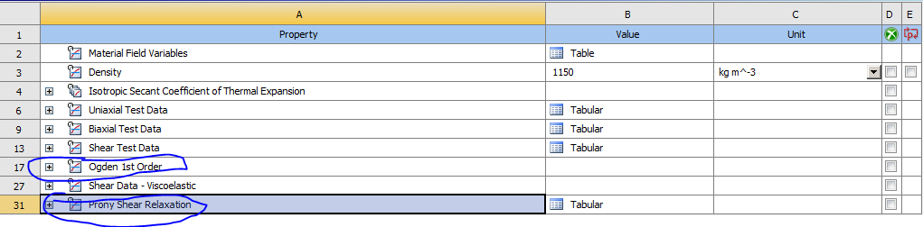

      Yes I want to have 2 curve fittings for one viscoelastic material.
      The first I did was the hyperelastic Ogden curve fitting for my Uniaxial, Shear, and compression test data to define my material.
      The second I want to do is the Prony shear relaxation since my model undergo relaxation, but unfortunatly, I found out that Ansys Workbench does not support 2 curve fittings.
      As such I need to do it in Mechanical APDL. But I can't find any leads on how to do the viscolastic prony shear curve fitting for a beginner in APDL.

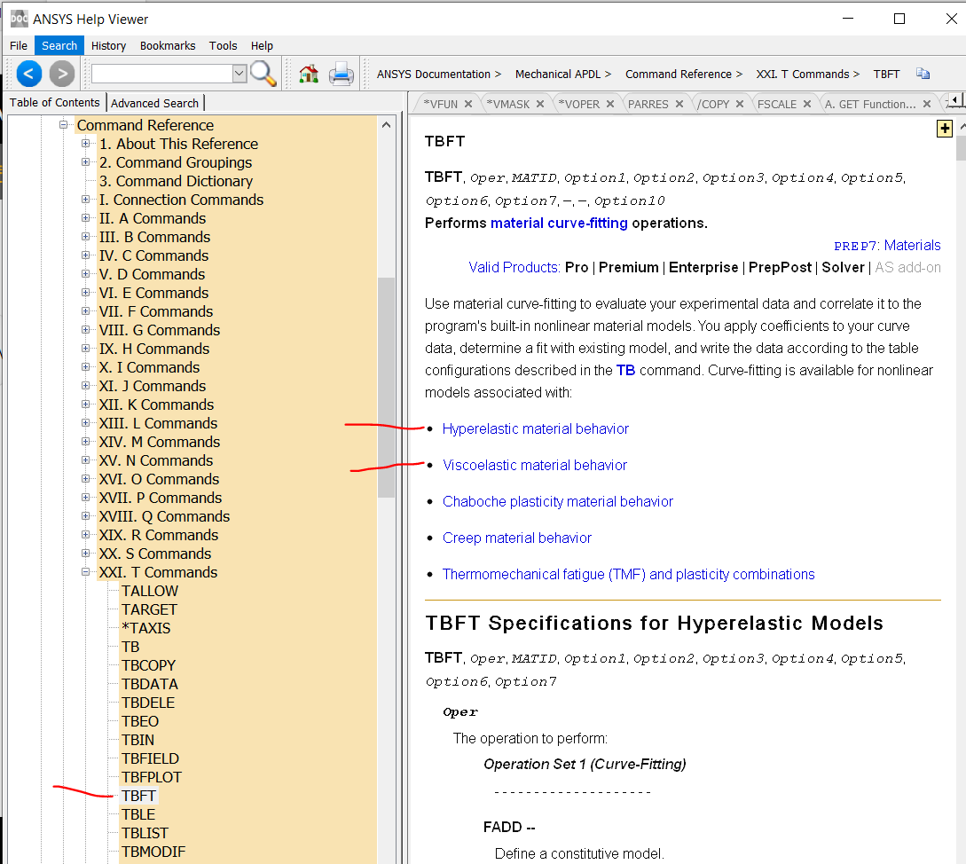

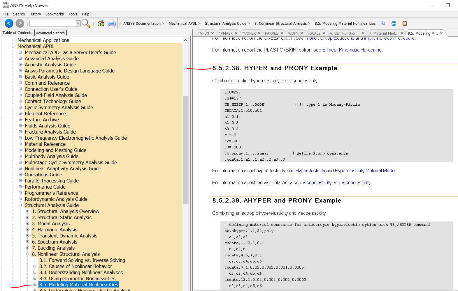

      I still need to get more details to satisfy your request, but I guess it might be prudent for us to first agree that it is possible to define combined hyperelastic and prony material models in MAPDL (see the two screen shots below): It seems possible to curve fit both viscoelastic and hyperelastic data to obtain the constants used to define material model constants:I see no prior mention of the TBFT command in this thread. Are you aware that this is central to curve fitting in MAPDL? Additionally, I could be wrong about this, but it may be necessary to obtain the constants for two seperate material numbers, then manually rewrite the commands that define the constants in such a way that they define both material models for the same material number.

      If your relaxation data is stress vs time, this curve fit can be done directly in Engineering Data.  Please refer to online docs Workbench=>Engineering Data Users Guide=> Material Data=>Curve Fitting=> Viscoelastic Test Data...
      If you have storage and loss moduli as function of frequency, then you are correct.  The curve fit needs to be done in MAPDL.  Please refer to Section 6.2 of the MAPDL Material Reference Guide...  It would also help to review the documentation on 'TBFT,,,' command in the MAPDL Commands Manual.  This procedure will result in Prony constants in the time domain (alpha and tau values), but the input is storage and loss modulii in frequency domain.  The MAPDL curve fitting results (alpha and tau terms), in this case, would need to be manually copied into WB-Engineering data.
      If you have access to the Ansys Customer Portal, please refer to KM 2036139 for a worked out example in MAPDL.

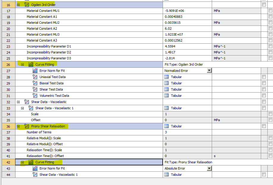

    • John Doyle
      You have two sets of data: one for the rate independent stress-strain (Uniaxial, Shear, and compression) and one for the rate dependent relaxation (Stress relaxation vs time).
      Curve fit the rate independent ogden model first.  Then curve fit the rate dependent prony series.
      These two mathematical expressions are combined under one material model to give you a large strain rate dependent material representation of your elastomer.
      Your engineering data should look something like this:
