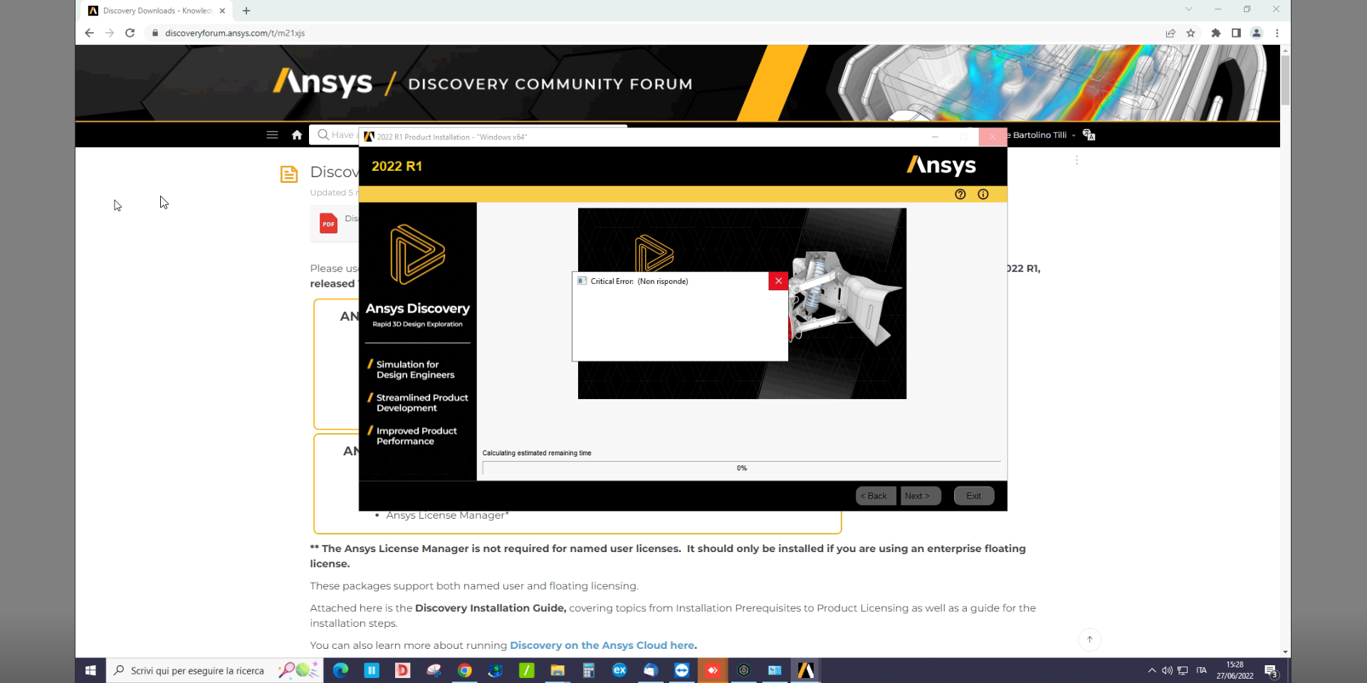

      I have a client who comes up with a critical error as soon as you start the installation.
      Has administrator rights and enough memory to install the software.

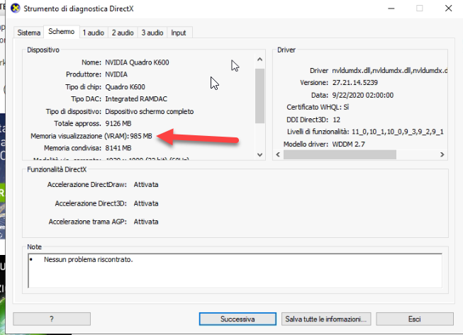

      Has a graphics card with 985 display memory that could be causing that?
      I have attached photos with the features
      Regards

        I imagined that the cause was because the dedicated card is under 1Gb, the other requirements are fine I checked

      The list for unsupported graphics cards is just for Discovery Explore stage. For Explore mode to work, you need minimum 4GB dedicated GPU RAM, while 8GB GPU is recommended and when running under Discovery Modeling at least 2 GB of discrete video memory is required (4+ GB recommended).
      For SpaceClaim: Discrete graphics card with the latest drivers and compatible with the supported operating systems. For full functionality, use of a recent NVIDIA Quadro or AMD Radeon Pro card with at least 1 GB of discrete video memory and supporting, at a minimum, OpenGL version 4.5, DirectX 11, Shader Model 5.0.
      Sorry for the confusion, in this case the cause for the error might be because the dedicated card is under 1Gb.

      Ciao  Devendra Badgujar
      La scheda viene venduta come DDR3 da 1 Gb, quindi SpaceClaim dovrebbe funzionare.
      Ho aggiornato i driver della scheda grafica.
      What else can be the mistake?
      https://www.nvidia.com/content/pdf/data-sheet/nv-ds-quadro-k600-us.pdf

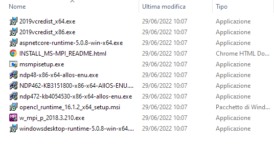

        hey can also try installing each of the items under C:Program FilesANSYS Incv221prereq to ensure they have the right prerequisites in place.

      How about installing each of these?
      • Devendra Badgujar
        Roberto
        Just to rule out the possibility please can you ask them to try installing each of the items under C:Program FilesANSYS Incv221prereq to ensure they have the right prerequisites in place, I see an message shown below:

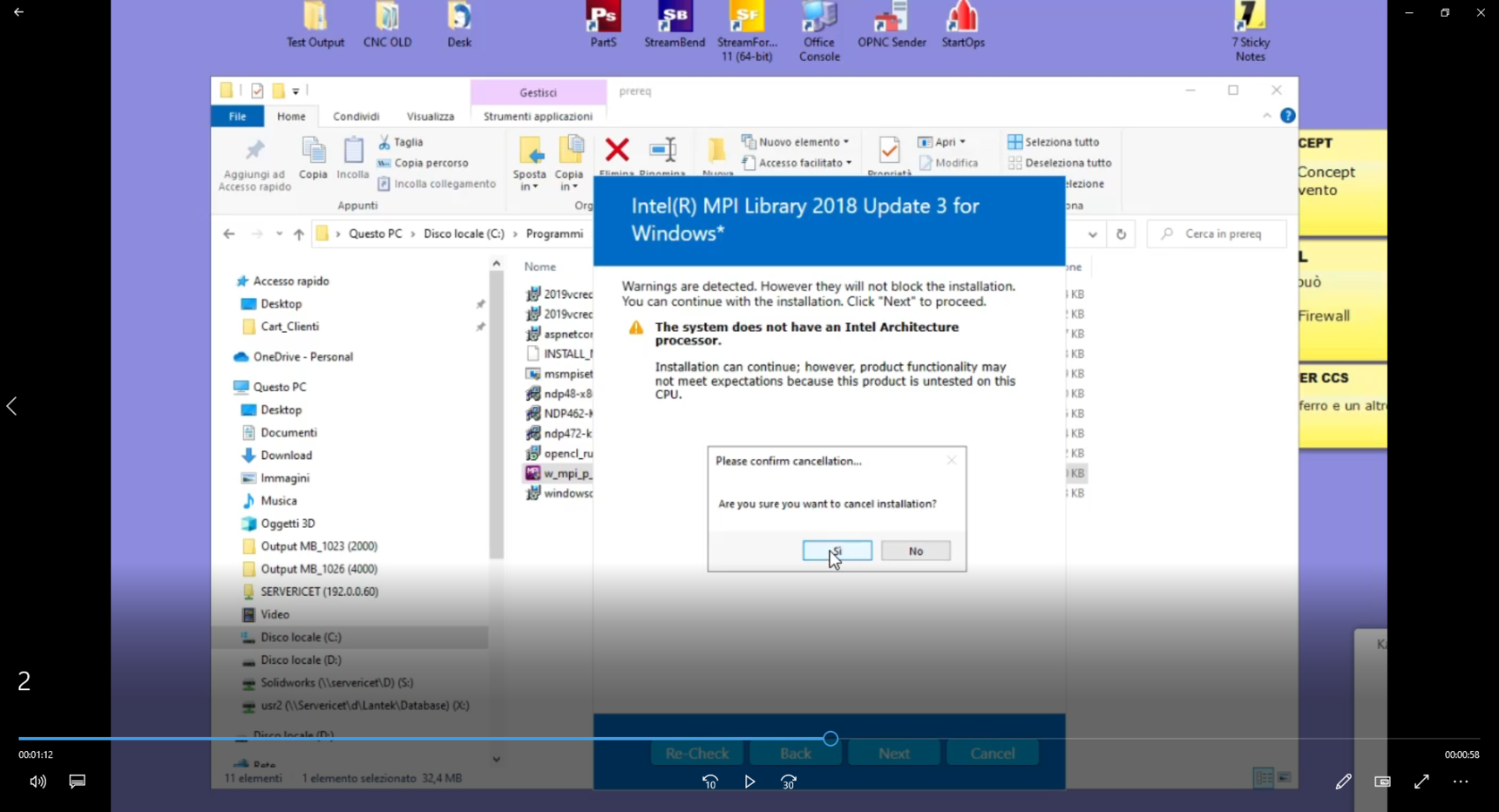

    • Roberto
      🛈 This post originally contained file attachments which have been removed in compliance with the updated Ansys Learning Forum Terms & Conditions
      Hello Devendra Badgujar
      I am attaching the videos of what I did, at some point from an error (I attach image) could that be the problem?
      Installing everything doesn't work
      Regards

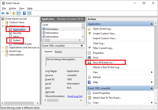

      Please open the Windows Event Viewer and have them save the Application and System events and share them.
