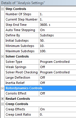

      Your Step Controls look like this:
      The error when your model runs is this:

      My suggestion: you should turn on Large Deflection under Analysis Settings. I'm not sure if you need Coriolis on or not.

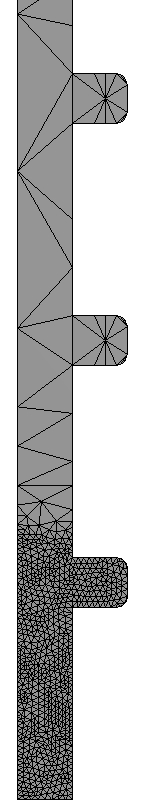

      On the left is the tet mesh in your model that has mesh refinement at the bottom where the highest stress will be found, but it is too coarse for a good overall result. On the right is a hex mesh using the Sweep method of Mesh Control, but without the refinement at the bottom.
      I'm currently running this mesh without creep, just to see the stress at 2000 radians/sec.
      I wonder why you have a frictionless support on the back. This prevents the belt leaving that plane. Isn't it possible that the mass of the ribs will pull a section of belt between the ribs slightly away from the back? That would surely happen if the ribs were a bit taller. To see that effect, a contact must be used instead of a frictionless support. The contact can be frictionless, but that would allow the belt to lift slightly off the plane.
      Ribbed belts like this are often engaged at both ends in some kind of wheel or clamp mechanism. This model has the near face constrained, but at the far end, there is no support along the belt axis. What is the real machine configuration at the far end? Isn't the ribbed belt engaged in something that would add a constraint at the far end too? If that is the case, the far end of the belt would go into compression and support some of the creep from occurring. It might also create slack in the belt that may allow the belt to buckle.

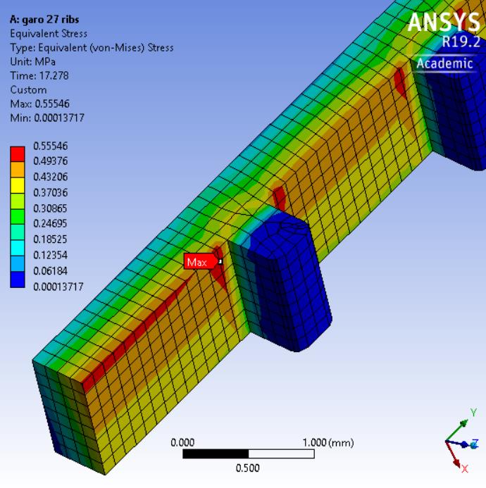

      I turned off creep in the Analysis settings to look at the stress in the part at 2000 radians/sec of rotational velocity. The model only reached 17 radians/sec before it encountered problems.

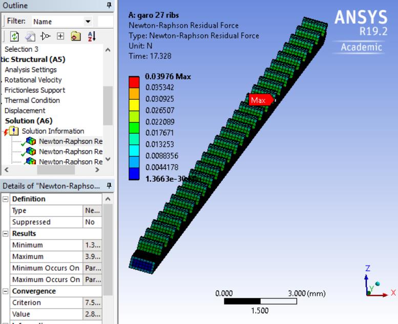

      Here is the Force Convergence Plot
      Here is some of the output

      The solver just gave up trying to converge.
      I'm interested to hear some input on this model.

      Why it does not converge (without creep), is because at ~ 980 celcius the whole fixed cross section yields, thus there is no way of balancing the centrifugal loads. At 760 say, it is OK, since the part there has not yielded yet. At 960 yielding occurs at half the value of 760 celcius (~1100 MPa). At 760 it is also ok with creep, but units creep constants (mm,..) need to be the same of course as in mechanical workbench (mm,..).
       I should also point out like mentioned this body is sweepable, thus a structured HEX mesh was used (elements size of about 0.2 mm)
      jj77, the yield strength for the material at 982 C is 428.9 MPa.
      The maximum equivalent stress in the part at 34 radians/sec is 0.55 MPa, so I don't think the convergence failure is due to yield across the whole cross section. [EDIT: Step 1 takes 100 seconds and goes to 200 radians/sec so 17 seconds is 34 radians/sec]
      I think it just needs smaller elements to converge, but I am bumping into the student limit here. I could make the elements twice as wide while making them smaller in the other directions to see if that makes the model get further along, but I am more interested to read an answer from Gerald about how the belt is supported in the real machine and whether the constraints in the model are a good representation of the real machine.

      I changed the mesh to have six elements across the belt and rib where before I had only four elements. The solver is running now, but has already gone further than it did before. That is what I mean about convergence in that model needing smaller elements.
      The motivation to get a uniform mesh along the length was because the tet mesh was too coarse to compute an accurate creep strain because the large elements did not capture the variation in stress over the cross section and since the creep rate is a function of stress, a significant error in creep strain could occur.

      I have managed to push the rotation velocity to to 1400 Rad/s by decreasing the time step setting to all 1 (minimum and maximum time step) with similar mesh sizes as you did.
      However i realize the more refined it gets the lesser Rad/s it  can accepts.(i am not sure why though) it may have to do with accuracy of the results.

      and i run it at 1900 Rad/s the results is as shown in terms of equivalent stress
      Would it be possible to know which part of it is closest to yield/failing because different portion has a different temperature thus different yield strength.
