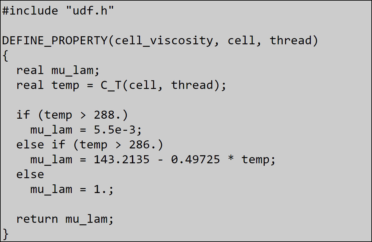

      I am trying to build a working UDF, but keep getting this error.
      Error: The UDF library you are trying to load (libudf11112) is not compiled for parallel use on the current platform (win64).nnThe system cannot find the file specified.
      nnU:Waxy Crude Oil PipelineUDF_RukthongRukthongTrial_filesdp0FFFFluentlibudf11112win643ddp_hostlibudf.dll
      Error Object: #f
    • DanMynhart
      /* UDF for specifying a temperature-dependent viscosity property     */
      D1;
      FD1;
      temp;
      viscosity;
      volume; /* real variable named volume is declared globally */
      main(compute_volume, domain)
      /* code that computes volume of some zone */
      volume = ((3.141*D1*D1)/4)*FD1;
      C_T(cell_viscosity, cell, thread)
      viscosity; /* local variable */
      temp = C_T(cell, thread); /* local variable */
      if (temp > 288.)
      viscosity = 5.5e-3;
      else if (temp > 286.)
      viscosity = 143.2135 - 0.49725 * temp;
      else
      viscosity = 1.;
      return viscosity;
    • DanMynhart
      This is the code we are using...
    • Keyur Kanade
      If you have udf which is working in serial mode then you will need to make some changes to that udf to work in parallel mode. Please see following link.
      https://www.learncax.com/knowledge-base/blog/by-category/cfd/parallelization-of-udfs-in-ansys-fluent
      Also for defining property you can use DEFINE_PROPERTY macro as shown in image below.
      Keyur
