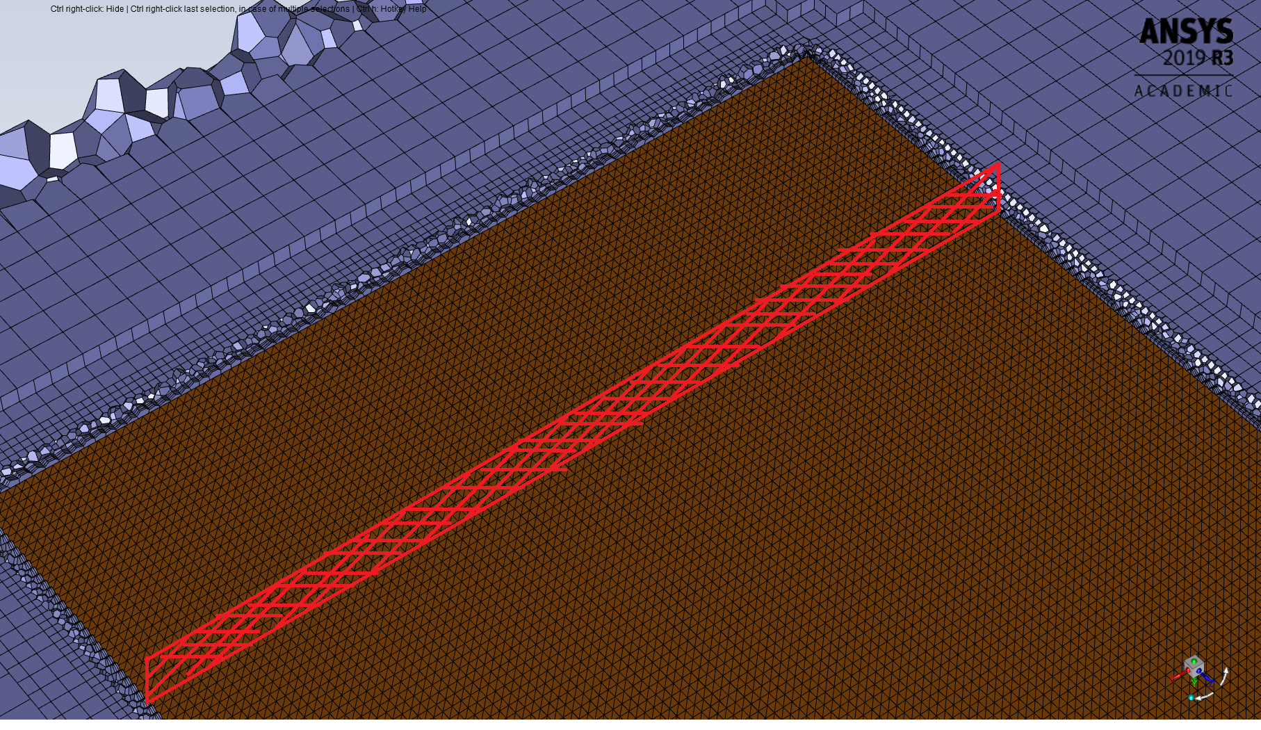

      I attempted to replicate the settings shown in the link you supplied, however there were a few problems I have encountered. My steps for geometry creation and meshing are as follows:
      1. Create air domain and hxc core
      2. Create rectangular surfaces and use Linear Pattern tool to create 199 surfaces which will act like fins, and thus dividing the core into 200 division per length.
      4. Group air and hxc core as separate components and labelling them as Merge in the properties. Group all fin surfaces as a single component and label it as None in properties.
      5. Next, I used the Share Topology tool in SpaceClaim and it identified the edges and baffles correctly and I applied sharing.
      6. After that, I named all the appropriate surfaces with Named Selection, for the inlet, outlet, fin, hxc-walls, hxc-inlet, hxc-outlet.
      7. Transferred the Geometry to Fluent Meshing via Workbench by linking the modules.

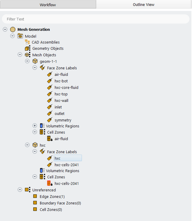

      8. In Fluent Meshing, I followed the Watertight Geometry workflow. Didn't add local sizing. Created surface mesh. Described geometry with fin and hxc-wall as walls, hxc-top and hxc-bot as internal.
      9. I'm not sure how to proceed after this step. I tried setting the hxc-core region as dead such that Volume mesh does not occur within this area. Instead I used Fluent Meshing's Mesh > Create > Heat Exchanger, to create the mesh for heat exchanger within this area and then Create Volume Mesh after this.
      After this step, I am not able to get the baffle surfaces in between the Heat Exchanger cells, and I lost all the surface meshes for the baffles, I think this is because I set the hxc-core to dead. I think I should be using Fluent Meshing's Mesh > Create > Heat Exchanger to create the cells for the Macro Heat Exchanger Model since this option is provided. However, I am not familiar with manipulating the mesh as I ended up having 2 separate cell zones as shown in the Outline View here.
      Is it possible to extract the surfaces within the Heat Exchanger cells to create the baffles instead?
      My goal was to create the vertical baffle surfaces, an example of 1 baffle surface is shown in the attached picture, between the structured mesh that was created with the Heat Exchanger option. And this structured mesh is embedded within an unstructured mesh for the air domain.
      Can you advise me if I have gotten any steps incorrect and how I could proceed with the settings in Fluent Meshing to obtain the baffles? Thank you.
    • Rahul Kumar
      I think the issue was in step 5. You do not need to add share topology, instead in the properties tab, under shared topology, select share (just like how you selected the merge option). This should do the trick.
