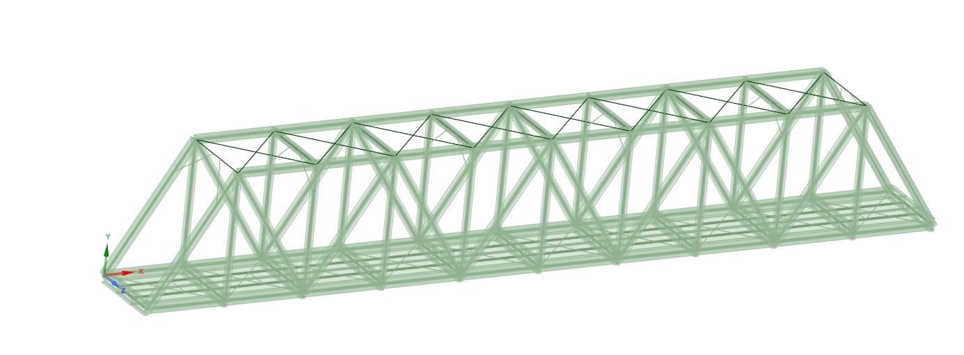

Now i work at bridge truss design in SpaceClaim. It looks like:Â

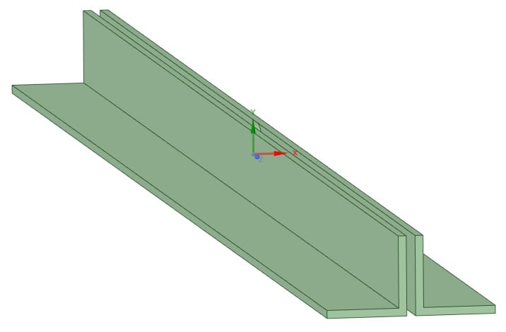

Top and bottom connection members have a double angle shapes with a distance between them:
Angles are connected together with a small plate between them.Â

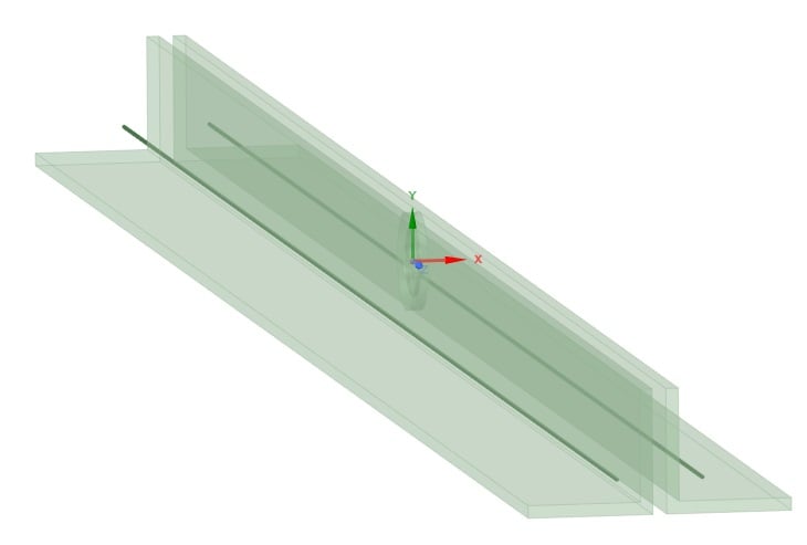

So, how can i choose this kind of profile for my truss members?Â
If i chose Beams-Extract option, it creates 3 different beam profiles:
So, how to make just one profile for 2 angles?

Forum ModeratorSorry, If there is a gap between two solids, they can not be combined as a single beam. Later, you can use contacts or node merge operations in Mechanical.
