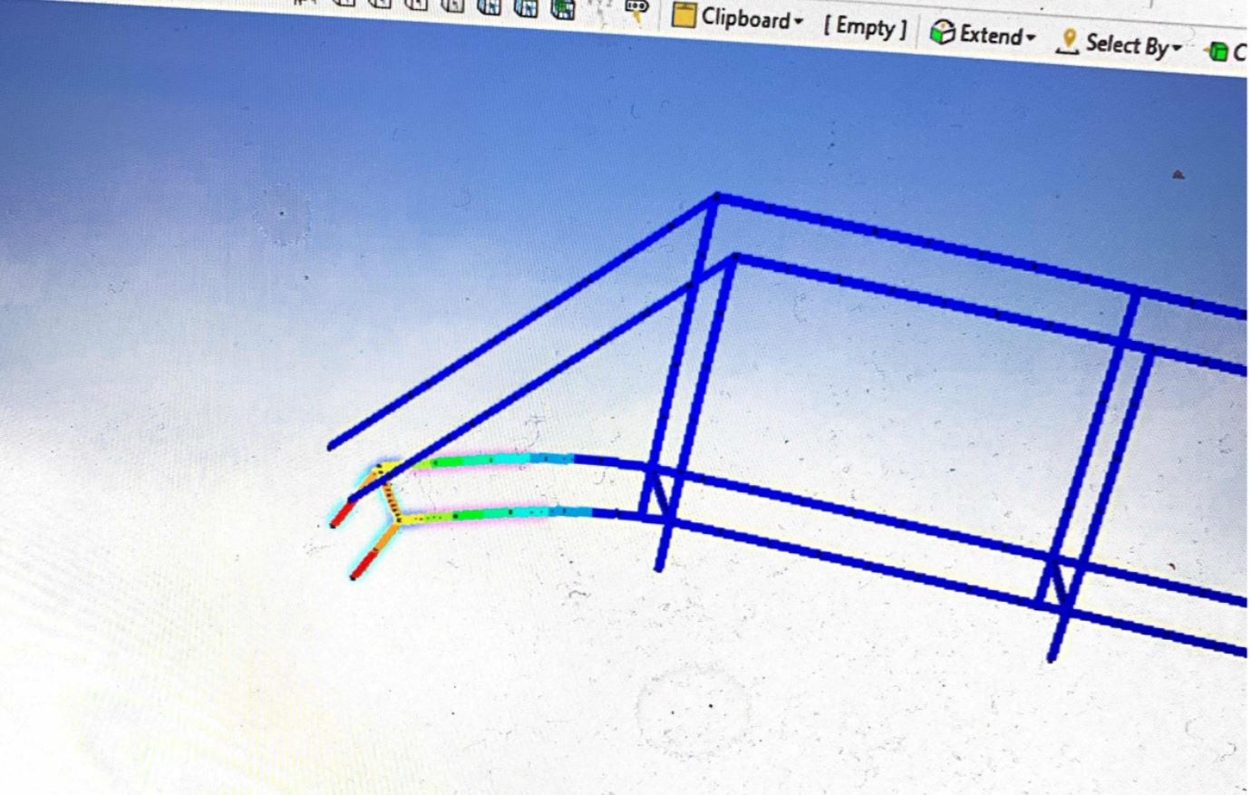

SubscriberHello,
I have tried to make this beamed bridge twice now, and I get all the way to solving it and I get a " pivot warning error". Is there any tips you can give me when creating and connecting lines. I have even tried every time hitting the escape button after every line so I thought so all the lines wouldn't be ran together. But the issue I am having is the lines aren't connected. when connecting lines multiple different lines is there a way to check if they are connected before going to solve?

SubscriberOne way to solve the problem was described here.
Another way is to use Shared Topology in SpaceClaim. Go to the Workbench tab and click the Share button. If two or more vertices are coincident, this will make them share a single vertex. This has the same effect of the Node Merge you did in the other discussion.Â
